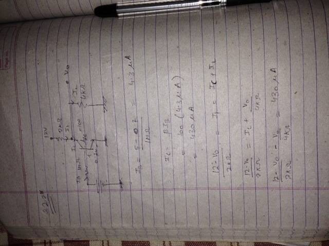

I have attached the images for the question and the way i attempted it please refer to it and tell me have i made any mistake.I have also attached the image for the solution provided by book, and my answer is not matching to the answer given in the book.
Question has asked to calculate the output voltage and it is (Q.28) for solution given in my book.

For the circuit in your first pic, your working & consequent answer are correct.
Correct. They forgot the current through the 4kΩ resistor (I2).
Ok. Thank you.
