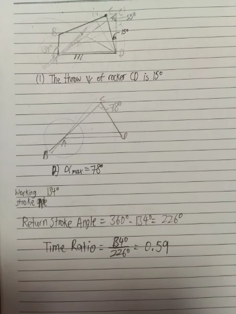

Did I do mine correctly?

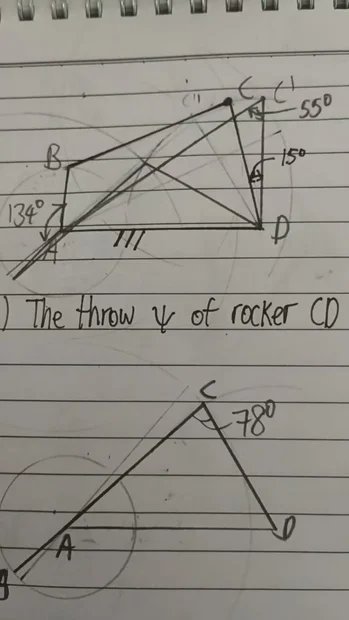

I don’t fully understand your diagram. It looks like you have superimposed three states in one picture:
1. Joint B is down to the left from A, with AB and BC at 180° to each other.
2. Joint B has been rotated so that angle CAB is 180°-134°=46°.
3. Joint B is further rotated so that ABC form a straight line.
The throw, then, would be the change in angle of CD from position 1 to position 3.
So what is position 2 and where does the 134° come from? I see no basis for it in the question text.
I agree with your 55° (well, 54 point something).

For the 134 degrees I drew the case where link AB and link BC are coincident and fold together. The I measured the angle between AB original position to the folded position which gives me 134 degrees. Maximum pressure angle occurs when the transmission angle is minimal, typically at extreme positions of the linkage. Thats what I think it is.

What angle, or difference of two angles, do you consider to be the 'throw', and what value do you get for it?
After some research, it seems that the "transmission angle" is BCD in your diagram. I'm still unclear what the "maximum pressure angle" is, but I here assume it is a particular value of the transmission angle, namely, that which corresponds to maximum pressure somewhere.
You wrote that it corresponds to the minimum transmission angle, so if my assumption is correct it would be that minimum value.
However, my intuition is that it means an angle at which the maximum pressure is exerted on joint C, and that would be when ABC is a straight line, yes?
In the actual setup, it can go past straight, making the transmission angle smaller.

It confirms that the position you measured the 134° from is purely illustrative. It is not relevant to the actual question. Just use the B'C' and B"C" positions.
I can’t find any description of pressure angle as it applies to a linkage.
For cams and gears it is defined as the angle between the pressure applied by the driver on the follower (which is normal to the contact plane) and the instantaneous direction of movement of the follower. But here we have two transfers: from AB to BC and from BC to CD. My guess is that it is angle between BC and the direction of movement of C. Note that the angle could be maximised after passing through position B"C", at which point it will be pulling on C, not pushing.
