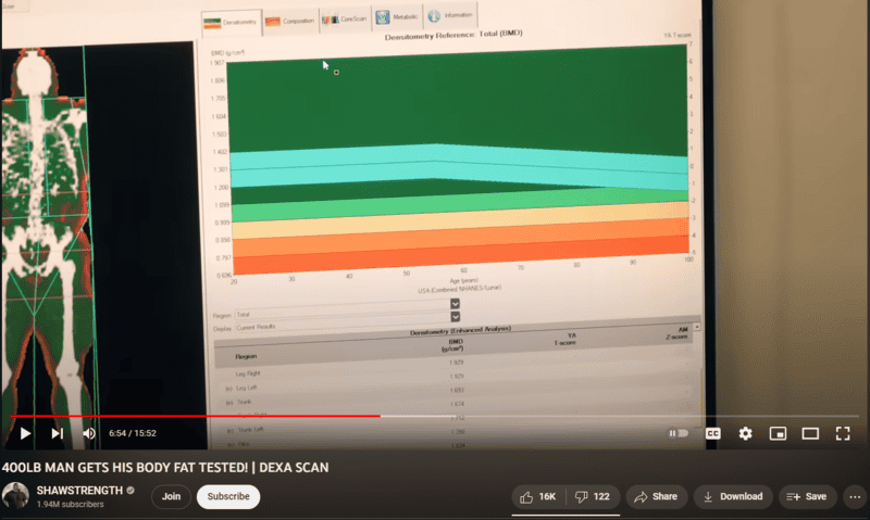

First, the strongman Brian Shaw's bone mineral content and areal bone mineral density
Screenshot of a DEXA body composition table titled Composition (Enhanced Analysis) with rows for Legs, Trunk, Android, Gynoid and Total, showing tissue %fat, total mass, fat, lean and BMC values in lbs.
Screenshot of a DEXA scan software window showing a total BMD reference chart with age on the x-axis and BMD on the y-axis, with a body scan on the left and a results table below.
Second, a bodybuilder Nsima Inyang's bone mineral content and areal bone mineral density

Nsima Inyang, despite being smaller than Brian Shaw have higher areal bone mineral density at 1.922 g/cm2 which we can get from dividing the bone mineral content with his total body skeleton size. His bone mineral content is 11.5 lbs which if we converted to grams will be 5216 grams. So, 5126 grams divided by 2713 cm which is the size of the total body skeleton is 1.922 g/cm2.
Brian Shaw, who have heavier bone mineral mass and larger bone, have less areal BMD (which is around 1.800 g/cm2 despite having heavier bone) than Nsima. Does that means Brian's bones are less stronger than Nsima despite Brian's bones being much bigger and heavier? Why is that?

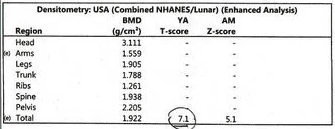

Table titled Densitometry: USA (Combined NHANES/Lunar) (Enhanced Analysis) listing BMD in g/cm² for Head, Arms, Legs, Trunk, Ribs, Spine, Pelvis and Total, with YA T-score and AM Z-score columns; the Total row, 1.922 g/cm², is circled.
Hi, I tried to add all the BMD numbers to get the total number like what is shown in the picture above and I get a wrong answer. What is the formula on how to find the total BMD with using the numbers from each regions?
That "total" looks to be the average of the 7 numbers, although I get 1.967 for the average, which is a little off. There may be some weighting also being considered, where larger structures contribute more to the average. Is it not described in the text?
No, it is not. Many other DXA reports also seem to contained similar errors especially with the total numbers. Also, the number for trunk part which already included ribs, spine and pelvis is already there. Do we need to treat ribs, spine and pelvis as separate parts from the trunk? Not sure. Very confusing.
Anyway, how do you managed to find the total? What is the formula?
If you're asking me, I said I took the average of the 7 numbers, so the sum of the 7 numbers divided by 7.
Does the text (or video, whatever) really not discuss how that "total" is calculated?
It looks like they are doing something similar with the Body Fat % numbers in their other table. It's most likely a weighted average based on volume, so you will need to find out the weights they are using for each section.
The source of the DEXA result picture above is from Instagram and I can no longer find the original account, but I managed to find this report online https://www.body-comp.com/wp-content/uploads/2016/12/body-comp-sample-report.pdf I tried to find how they calculate the total but still can't find it.
