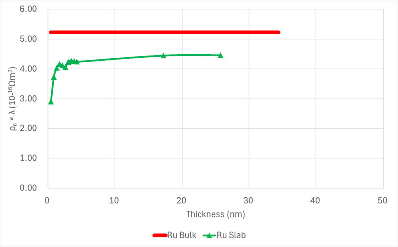

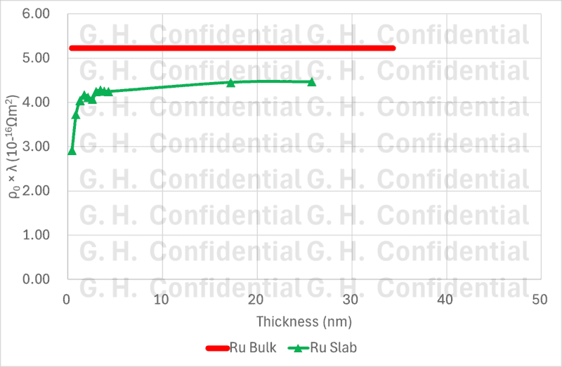

My thickness datas
Slab structure

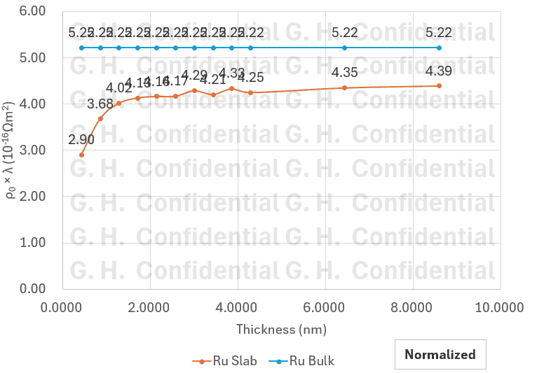

I have been calculating the ρ×λ of metals at various thicknesses to find out the thickness dependence, and now I have a problem.
Well, I've tried to compare the resistivity of bulk and slab by using ρ×λ calculation (by using QE and BoltzTraP2[2]) and there I found slab's ρ×λ doesn't match with bulk value.
For example, ruthenium primitive cell, its ρ×λ property is 5.14*10^-16 [Ωm^2] in the paper [1] and I got 5.22*10^-16 [Ωm^2] from my BoltzTraP2.
But, while I make the system as a slab (i.g. add some 15 Angstrom vacuum along the Ru HCP 111 direction) its value comes out much smaller than the bulk after normalize, it has 2.9*10^-16 [Ωm^2].
I thought this because slab is too small to get the proper bulk characteristic, so I've also tried more larger size over 10~20 nm.
(the Ru has <10nm electron mean free path)
But in this size, the value is still small than bulk.
Also, they do not seem to match after increasing the size.
As far as I know, BoltzTraP2 doesn't have a relaxation time approximation, so it doesn't show the reduction in resistivity caused by surface scattering as the size scales. So I think they only have the electron band structure data, and these values leads some thickness dependence.
What can lead the thickness dependence in this situation?
Does slab and bulk has difference resistivity normal?
Thank you for all who read this question.

I agree that in the limit of thick slab contributions of the surface should impact less, thus, recovering the bulk value. You have a ~15 % relative error, it could be a convergence issue in the DFT. Did you check:
- convergence parameters (k-mesh,smearing,cutoff) both for the bulk and slab ?
- total energy per atom. Slab and Bulk values should approach each other in the thick limit, I believe.
It may be that you are running un-converged calculations.

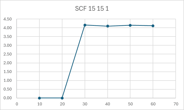

<Convergence test>
Ru Slab with 4 unit cells along the c direction which means it has 8 atoms and 15 Angstrom vacuum along 'c' direction.
Tested by using NSCF data, based on SCF (15x15x1).
x axis is number of NSCF k-points along 'a', and 'b' direction which mean 10x10x4, 20x20x4, ... 60x60x4.
I choose 50x50x4 for right convergence of Ru slab.

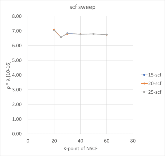

Primitive cell convergence (Cu, I lost my data of Ru)
for bulk, the primitive cell, k-points set 50x50x50 (for NSCF, 15x15x15 for SCF)

Sorry I don't quite follow your tests.
First of all, is your system magnetic?
About the convergence. Let's start with the SCF. How did you pick 15x15x1? And why those values for the smearing? Also the suggested value for cutoff seems to low in my opinion. Please also converge that value.
Note that you have to converge again for different systems (Cu and Ru could require different converged values).
In principle, what you do is the following:
- run SCF calculations for different values of psi_cutoff = 40,60,...,100,120,..., and rho _cutoff ~ 10*(psi_cutoff) and plot Total Energy vs cutoff. You should get a converging curve.
- repeat the process, but varying k-points and smearing. Plot Total Energy vs number of k-points for the different values of smearing, and again chose an appropriate value. 0.02 could be to low in my opinion.
Ideally you want an error on the total energy of the order of 1 meV.

1) How did you pick 15x15x1?
I choose 15x15x1 because there is not quit big different between 15x15x 1~ 6 and also 20x20x1 or 30x30x1 (as I attached the fig on my previous reply).
Indeed, I tried to reduce the calculation time of scf as it use too much time on iteration.
So I allocate less k-points on scf, and more k-points on nscf.
After, the BoltzTraP2 use nscf data to interpolate and the converged rho*lambda comes out as like above.

My main question is that, does slab can approach the bulk value?
As I tested, the slab value seems saturated.
Yes it should, because surface contributions scales as ##L^2##, while bulk as ##L^3##, therefore in the thermodynamic limit (##L \rightarrow \infty## they should not matter). That is why I am assuming calculations are not converged. Either that or the software has some problems.
from you post I see that k-mesh is well converged. Try converge rho and the smearing value. I saw the link you posted. In page 40-41 it is well explained all the convergence test that you should do. Follow the same steps and be sure the parameters are converged. (Convergence on rho is discussed a couple of page earlier)
