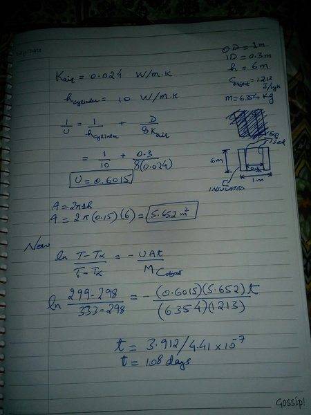

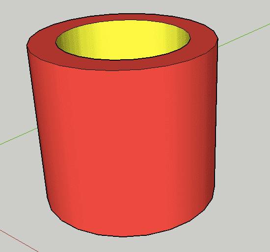

Please see the hollow cylinder.The red colored sides are insulated and the only exposed surface is the hollow pipe surfaces
hello chester. I have posted a picture of the cylinder i was discussing with you. Please see the cylinder is insulated from the sides with red color (the bottom side isn't visible in the pic but that is also insulated similar to top side) and the yellow color surfaces in the hollow pipe area is exposed to room conditions. The length of the steel cylinder is 6 m, OD is 1m,ID is 0.3 m,To is 333k ,Ta is 298k, T is 299k , specific heat is 480 j/kg k, Thermal conductivity is 0.4 w/m k...the insulation is of NBR with specific heat is 1430 j/kg k, Thermal conductivity is 0.4 w/m k...can you help me find the cooling time...I m getting too many days which seems wrong

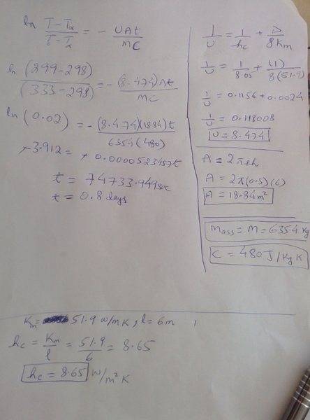

I thought you said that the outside heat transfer coefficient was 25.
that was a random value i picked . However while exploring this issue over the internet. i came to this relationship for heat transfer co efficient h=k/l where k is the thermal conductivity and l is the thickness/length of the object
This is done incorrectly. First of all, you should be using the thermal conductivity of air, not the thermal conductivity of the metal. Secondly, you should be using the thickness of the natural convective thermal boundary layer as the length l, not the length or diameter of the cylinder. Typical values of the heat transfer coefficient for natural convection heat transfer from a cylinder are on the order of 3 - 20 W/m K. So, from this range, what value would you be comfortable using?
10 w/m k would be fine

OK. Redo the calculation with that value please.
still seems incorrect...specific heat i have used of my specific object...rest all values as u suggested
$$\frac{1}{U}=\frac{1}{10}+\frac{1}{(8)(51.9)}=\frac{1}{10}+\frac{1}{415.2}=9.76\ \frac{W}{m^2\ K}$$
Note that, even though the cylinder diameter is very large, the heat transfer is still dominated by the outside convective heat transfer coefficient.
$$V=\frac{\pi (1)^2(6)}{4}\ m^3=4.71\ m^3$$
$$M=(7870)(4.71)=37100\ kg$$
$$MC=(37100)(480)=17800000\ J/K$$
$$A=\pi (1)(6)\ m^2=18.84\ m^2$$
$$\frac{UA}{MC}=\frac{(9.76)(18.84)}{17800000}=\frac{1}{96847}\ sec^{-1}$$
$$\ln{\frac{(30-25)}{(90-25)}}=-2.56$$
So, $$t=(96847)(2.56)=248000\ sec=2.9\ days$$
