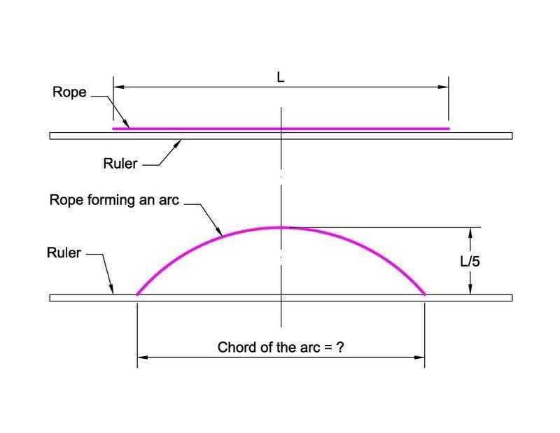

I was playing with a small piece of rope I had on the table, moved it to a curve - circle segment - and figured I wanted to calculate the distance between ends of the curve - and failed. Now I'm confused and embarrassed.
Here is what I did:
The rope has length L. I put the ends of the rope on a ruler (straight line). The ends are free to move along that line, but not allowed to leave that line.
Now I move the center point of the rope L/5 away from the ruler. Given the restrictions that the center of the rope is fixed L/5 away from the ruler, and the ends has to be on the ruler line I arrange the rope into a part of a circle.
How can the distance between the ends of the rope be calculated?
Did I understand your description?
Two-part diagram: top shows a straight magenta rope of length L lying on a ruler; bottom shows the same rope forming an arc on the ruler, with its height labelled L/5 and the chord of the arc marked as unknown (?).

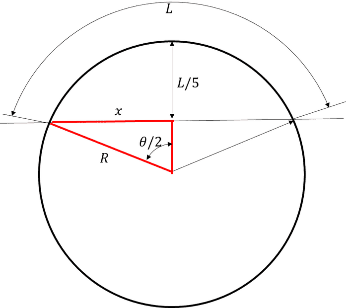

Diagram of a circle with a thick arc of length L drawn over the top, with a horizontal chord x, radius R from the centre to one chord end, half-angle theta/2 at the centre, and a vertical label L/5 from the chord to the arc top.
You have a few equations to work with involving ##\theta,L,R, x ## ( we only know ##L## and the fact is forms part of a circular arc )
Hint: Think arclength (circular sector), tangent, and Pythagoras ( red triangle). Can you write them for us?

I'll redefine the angle to be ##\theta## ( as opposed to ##\theta/2## - it's better that way. )
Circle with a chord drawn horizontally near the top, a tangent line crossing each end, and a red right triangle with legs x and L/5, hypotenuse R, and central angle θ marked; arc length L labelled above.
So we get:
$$ L = R 2\theta \tag{1} $$
$$ \frac{R - \frac{L}{5}}{R} = \cos \theta \tag{2} $$
Combining those I get what you do
$$ 5 \left( 1 - \cos \theta \right) = 2 \theta \tag{3} $$
## \text{3}## is unfortunately the numerical solution that needs to be found.
However, you can continue to work on ##x## with another trig relationship, and Pythagoras. You are going to eliminate ##R## in these steps between two equations.

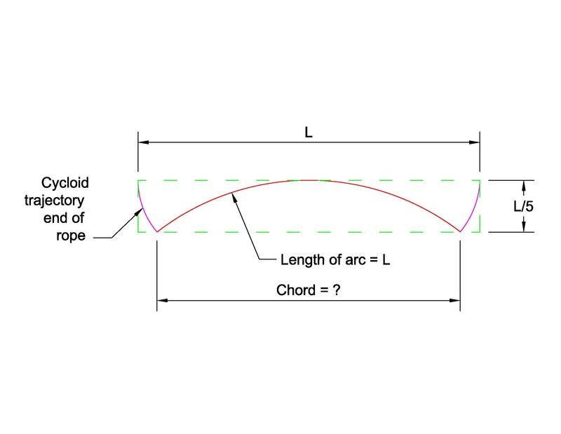

Could a mathematical solution be found for the intersections of a line, an arc and a cycloid?
Diagram of a red arc of length L spanning a horizontal distance L, with its ends joined to magenta cycloid curves; a dashed green box marks a height of L/5, and the chord between the arc ends is labelled Chord = ?.
Diagram of a blue circle with a black centre dot and a red dot on the horizontal black line where the circle touches it, showing a rolling circle at the start of a cycloid.

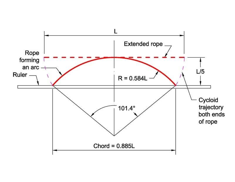

Just to be used as a reference, I have graphically found the following proportions:
Diagram of a rope lying on a ruler and forming a circular arc of length L, with dashed extended rope above, labels R = 0.584L, chord = 0.885L, angle 101.4°, and height L/5 marked.
