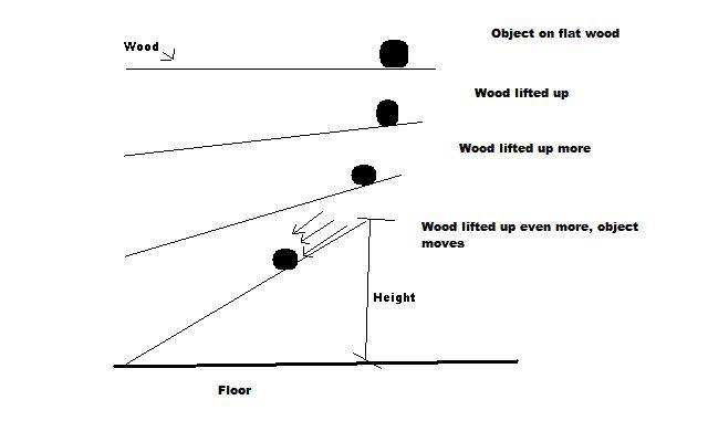

There is a 730g object on a piece of wood measuring 91.5cm. If you slowly lift one end of the wood, predict high would you need to lift it in order for the object move.
The attachment has a picture of what is happening
I have figured that the force of gravity it 7.3N and I have drawn a force diagram. I know how to find all the forces, but i do not know how to tell when the object's force has overcome friction. If someone can tell me how to tell when this happenes, I can solve the rest of the problem by myself. Thank you
The object begins to slide when there's a net force acting down the incline. What are the components of the weight? Are you given the coefficient of friction? How can you calculate the maximum value of static friction?

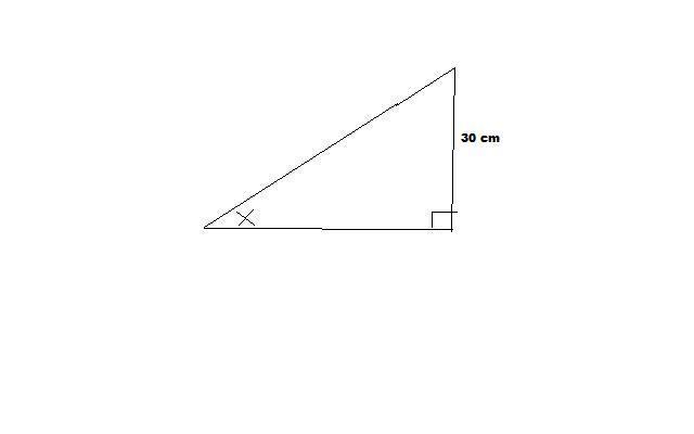

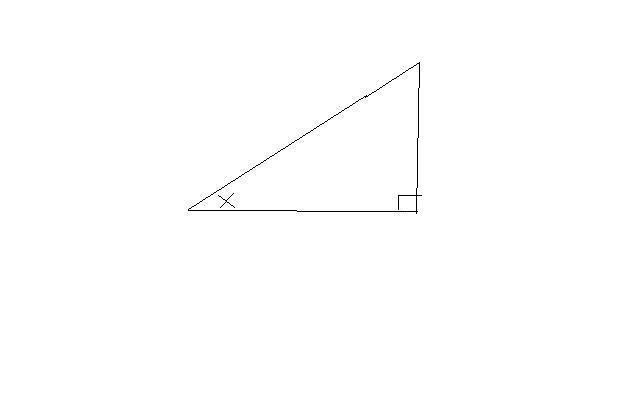

Is this where x is for Tan(x)?
now I am all confused... Do I need to estimate a height, use that to get the angle from my attachment above, then take that angle put it into tan(x) to get the coefficient?
I have guessed a height of 30 cm. That gives x an angle of 19.27 degress

No, you are estimating the coefficient of friction (LHS of the equation I gave you the hint about).
So...if mu = coef. of friction and x is the angle as shown in your diagram then...
mu = tan(x)
Using one of the estimated values from the link (say wood and brick) we have
mu = 0.6
So the arctangent of 0.6 is about 30.96 degrees which equals x.
Since you know x now, you can use some basic trig to find the height.
oh, ok
I got the angle of x to be 26.57 degrees, and then the height to be 41.18cm.
