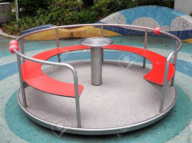

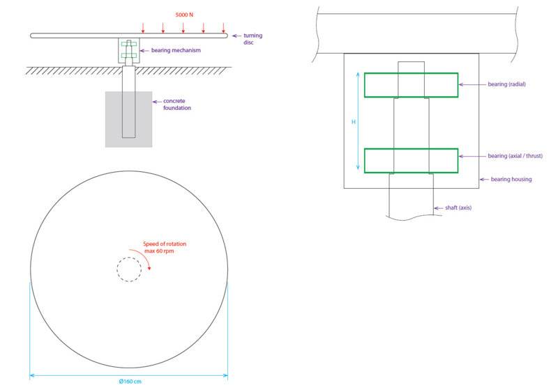

I am in the process of developing a playground carousel (see example attached) and need to calculate some forces acting on the construction in order to design the bearing mechanism and select the correct bearings for the job. I've made an outline which you'll find attached, with all information i have currently available. A load of 5000N will be applied on one side of the spinning disc Ø160cm (= 63 inches) and rotated at a max. speed of 60 rpm (handdriven).
A bearing mechanism for a carousel typically consists of two bearings: the lower of the two bearings will be mostly loaded axially (thrust), the upper bearing will be mostly loaded radially.
- Can you help me out in determing the loads in this configuration? Espacially the radial load, since the axial load is quite straightforward.
- I am not sure about the minimum required space between the two bearings (dimension H) either, so any suggestion or advise regarding this is also greatly appreciated.
  • carousel outline.pdf
Dag Yves,
5000 N corresponds to a mass of 500 kg, about five adults.
To make them spin at a sickening 60 rpm (## \omega = 2\pi\ ##) radians per second requires a centripetal acceleration of ##\omega^2 r \approx 32 ## m/s2 , or about 3 ##g##, meaning a radial force of ##m \omega^2 r \approx ## 16 kN
This force has to act at the back rest (or rather at the radius of the center of mass, so the actual r < 0.8 m), so a bar as in the picture is utterly uncomfortable !
( I hope you are doing a kind of worst case study !)
In practice people lean forward, thus reducing the effective r, but when they are forced to give up due to high ##\omega##, things can become painful
As said, this radial force has to act at the back rest, so a radial bearing as high as possible is recommended. The the distance h to the axial bearing should be high to allow delivering the torque needed to 'axially move the radial force'Since - as shown in your example picture - the 'steering' wheel is necessarily mounted on the static axis, it would be an idea to mount the radial bearing as high as possible and have the axial bearing as low as possible (it will still have to deliver a radial force, though -- see preceding paragraph).
Find one of these things and try it out. Do some measurements with a (stop)watch -- 60 rpm seems unrealistic to me (and it contributes quadratically!).
If your device is not like in the picture but as shown in the drawing, the story is quite different, not physics-wise but number-wise.

Hello BvU, thank you very much for taking the time to look at my problem and submitting this helpfull calculations.
- Yes, the 60 rpm has a safety factor included. I tried rotating a similar carousel myself for one minute (without children on it!) and reached 45 rpm.
- Your recommendations about the radial bearing inside the tube of the handwheel (and as high as possible) seems the logical solution indeed, but i am investigating the design as in the pdf were the bearings are both underneath the platform, so i can have one mechanism for possible other variations as well (standing models without seats or central handwheel).
