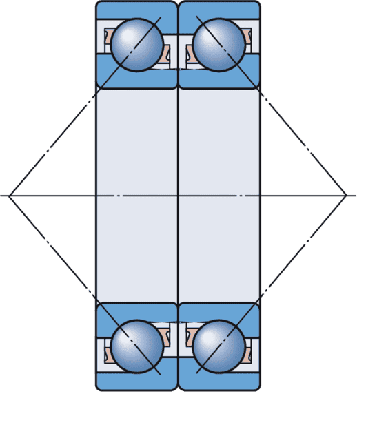

The orientation is back-to-back arrangement (that is indicated by the dotted lines in my sketch) (reference image attached) if that is what you meant by orientation. Yes, you are right but I am not aware of which is what since the setup was manufactured way before I started working on it. One of them is a locating bearing i.e. fixed side to position the shaft axially and the other is a non-locating bearing i.e. free side (radial clearance exists in between the housing and outer race) to compensate for shrinkage or expansion. But, I anyway think your guess is correct, lower one is non-locating and upper one is locating.

There are many ways of stacking multiple angular contact bearings to optimise load handling, alignment control, or convenience of assembly-disassembly. The original diagram was confusing because the dotted line could be through the two ball contact points, or tangent to ball at the contact surface.
Since the two bearings are on the same side of the steps, and you do not show the housing, I have to assume there is something not shown that stops the shaft falling out of the machine. That other something will offer preload. You have minimised the diagram and hidden half the reaction forces.

Okay, I get you now. So, there is a common housing for both the bearings and it is clamped on by 4 bolts fastened to a vertical flat plate. I hope this gives clarity.
No.
Both which bearings ?
What does the clamp plate act against ?
I think you need a more complete diagram.
