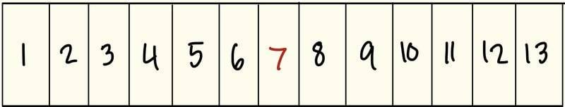

In my Physics lab, we divided into groups and our task was to throw darts on a target containing 13 bins. The ultimate goal is to hit bin 7. The bins look something like the image below. At the end, our class combined each groups average, standard deviation, and standard error (located below). There is a class table provided below where each group combined each of their data (how many darts landed on different bins) into one table. There are two questions (posted at the very bottom), problems 9 and 10, from the lab that puzzles me. If you need any more info, just ask me about it. I've been thinking about this for 3 hours and I can't make sense of it.
Here is the target. It was just a paper that we pinned to the wall. All 13 bins.
Paper target divided into 13 numbered bins in a row, labelled 1 through 13 left to right, with bin 7 labelled in red.

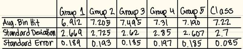

Here are data for each group and also the combined data from the class as a whole under the column "Class"
Handwritten table of dart-throw statistics for Group 1 through Group 5 and the Class, with rows for Avg. Bin Hit, Standard Deviation and Standard Error.

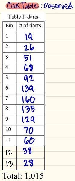

Here is the class table (how many darts landed on different bins for each group combined)
Handwritten class table of observed dart counts for 13 bins, with bin 1 through 13 and totals of 1,015 darts.

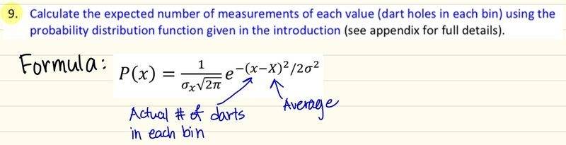

Problem 9:
I calculated the expected number for the bin #1. I plugged in 2.7 for the standard deviation and 7.22 for X (average) and got 1.09E-5. I thought this formula was supposed to calculate the "expected number of darts" for each bin? 1.09E-5 doesn't seem to make sense, or maybe I'm misunderstanding this formula?
Handwritten note on a lab worksheet, problem 9, with the Gaussian probability formula P(x) = 1/(sigma_x sqrt(2 pi)) e^(-(x-X)^2/2sigma^2), with blue arrows labelling x as the actual number of darts in each bin and X as the average.

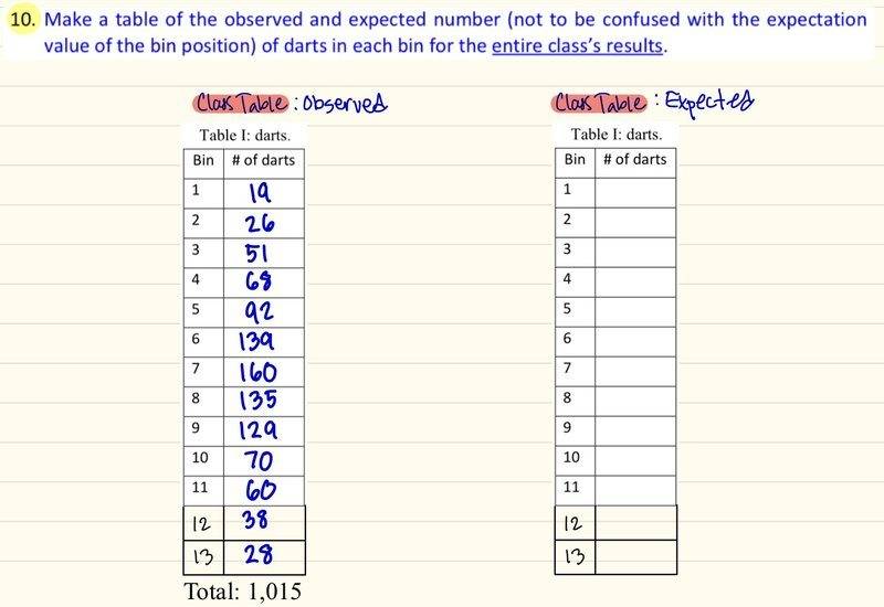

Problem 10:
For this problem, do I just copy down whatever answers I get from problem 9? Though from the answer that I got for bin #1, it doesn't make sense to put 1.09E-5.
Worksheet question 10 with two side-by-side tables labeled Class Table: Observed and Class Table: Expected, each listing bins 1 to 13 and number of darts; observed counts are filled in, expected column is blank, total 1,015.
The formula you are using in 9 is the pdf of the normal distribution, not a number of events. It gives you the probability that a single dart will end up in a small region of size ##dx## as ##P(x)dx##. Now, your distribution is discrete, not continuous, but if the discrete steps are small enough in comparison to the spread, you can use the size ##\Delta x = 1## of the bins in place of ##dx##.
In addition, ##X## is the average position, not the average number of events, and ##x## is the position of your bin, not the number of events in it.
Now, you should be able to compute (at least approximatively) the probability of a single dart hitting a bin. If you know that, how many darts do you expect to hit a bin if you throw 1015 darts?

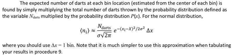

Here is the right formula that I found on my paper that calculates the expected number of darts at each bin location
Text explaining that the expected number of darts in each bin is Ndarts times the normal distribution P(x), with the formula <n_i> ≈ Ndarts / (σ√2π) · e^(−(x_i−X)²/2σ²) · Δx, where Δx = 1 bin.
