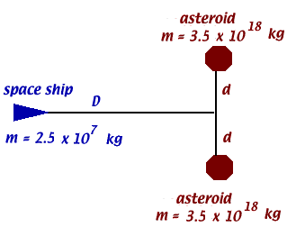

If D = 2323 meters and d = 1234 meters in the figure, what is the magnitude of the force on the spaceship to the nearest MN? Consider all three to be point masses.
F=(Gm1m2)/r^2
For this problem I have tried to use the above equation and have not gotten it correct yet. The distance from the ship to either asteroid is 2630m. MN I guess is for MegaN?

Yes, I think it's mega Newtons. You need to use some trig here. Draw a force diagram and split it into horizontal and vertical components. The vertical ones on the spaceship cancel. The horizontal ones add.
I still can't get this thing right. Do I have to find the angles first then the difference of the forces?

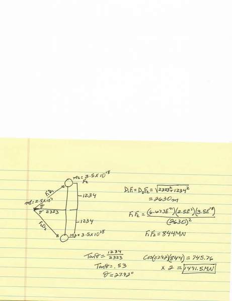

ok so my horizontal vector will be (2323,1234) + (2323, -1234) = (4646,0). Right? then I use that in the formula and I get ~270MN. I still think I either don't get it or I don't know what I'm doing, but I been trying really hard. If someone could walk me thru this I'll appreciate it. Not giving up until I get it.
Thanks
I can't fault you for not trying and don't give up. But it really seems like don't know how to work with vectors. Ok, I'll walk you through it. You know each force vector has a magnitude of about 844MN, right? Stop me when you don't get something. Each vector makes an angle with the horizontal. Split each vector into horizontal and vertical parts whose sum is the whole vector. You can find the horizontal parts by multiplying the magnitude by the cosine of the angle, and you can find the vertical parts by multiplying by the sine of the angle. That's the trig part. Have you ever seen this before? You don't need to find the vertical parts because you can see from the diagram they point in opposite directions and will cancel. Are you still with me? You do need to find the horizontal magnitudes because they point in the same direction and will add. So the total force is directed towards a point in between the two asteroids. And that magnitude is 2*cos(angle)*844MN. To find the angle you can use trig again and realize that the cos(angle)=adjacent side/hypotenuse of the triangle (or you could use tangent) so cos(angle)=2323/2630, you already worked the 2630 out before. Is this making any sense at all? And you may need to check how some of these figures round off to make sure you are within 1MN of the answer. That's the best I can do for a walk through.

I think I got it right now. All the confusion that had me puzzled was when you said what angles. Think I might have miss-understood that, but it clicked with your last post.
