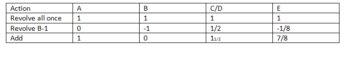

Here the gear B is fixed and C and D are on the same drive. If C has 100 teeth, B has 50, D has 50 and E has 200. Calculate the ratio of the gearbox.
My attempt is uploaded as an attachment as putting tables in here is a bit of a mission, just wanted to see if what i have done is correct. Thanks a lot in advance!

  • Table of a Willis-method gear train calculation with columns A, B, C/D, E and rows Revolve all once (1, 1, 1, 1), Revolve B-1 (0, -1, 1/2, -1/8), and Add (1, 0, 1 1/2, 7/8).
