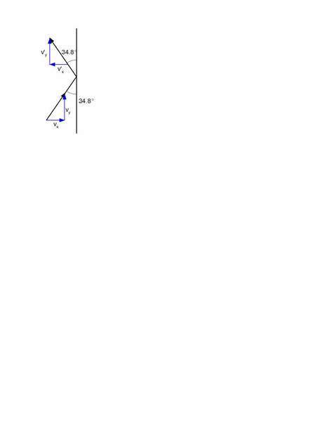

In your second attempt, when you calculated the X and Y components, you found the components of the momentum in the two directions. That's fine. But I don't see what you were doing in calculating vf as the square root of the sum of squares of the momenta. That should just give you back the momentum, not a velocity.
When the puck hits the wall, the velocity and momentum in the y-direction remains unchanged (because the angle of reflection is equal to the angle of incidence, and the overall speed is said to be unchanged). But what happens to the velocity in the x-direction?

Yes, the same *magnitude* of components. But the sign of one of them has changed. This is important. Why is it important? Because you're looking to find the impulse, which is the total change in momentum, ∆p, that occurs during the impact of the puck and wall.
Momentum is a vector quantity, just as velocity is, which means that it has magnitude and direction. Momentum has the same direction as velocity. You are going to want to find the difference between the initial (incoming) momentum vector and the final (outgoing) momentum vector.
Now, only one of the velocity (and momentum) components is changing over the collision. So the change in momentum will be confined to that component that is expressing the change. I'm aiming to get you to identify which component that is, and to calculate the change in momentum.

Attached is a diagram of what is happening. Note that the Y-component isn't changed, and the angle to use is the 34.8° that was given -- it was stated that the angle was with respect to the wall, not the normal to the wall.

Okay, I've got up to there... Now I have my diff velocities for x which is changing from 3.05 m/s to -3.05 m/s after collision. Do i just take the difference in momenta between the 2 components... or do i have to resolve again?
Oh wow... I can't believe it took me so long. Thanks for being so patient guys! :)
No need to resolve now, since these two velocities are both lie along the same line parallel to the x-axis; they're x-components.
Just form ∆p from m∆v.
