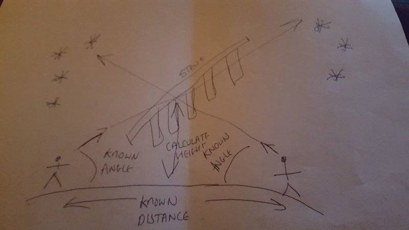

astroscout
62
A friend of mine was able to photograph STEVE and later found out that another photographer also captured the same event. One captured it from the south and the other from the north. He has asked me if using the the information from both locations, can the height of STEVE be calculated? The two photographers were about 370 km apart. Here is a drawing he sent me via Facebook.

then upload it here as a file.Yes. You could calculate its height if you can get an accurate idea of the angle above the horizon from both pictures. That'll be easier said than done.
The next question is: will you get a more accurate altitude than that understood to be STEVE's normal.
According to Wiki, that's about 280mi.

Yes. As described. That's how you'd calculate it.
Those "known angles" oughtta be tricky tho.

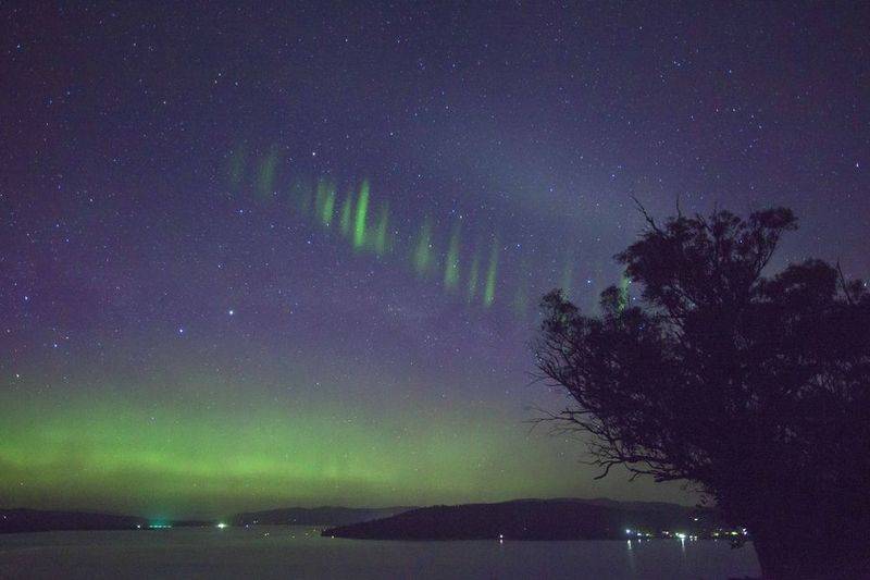

Here is a screen capture of STEVE taken from the video at youtube.I enhanced it a bit to show the purplish color. This was taken by Paul Smith in Grassland, Alberta in Canada. He will use Stellarium to figure out the angle from his location.
ummm... that's the picket fence style aurora
STEVE is usually a single band, like a streamer across the sky
https://en.wikipedia.org/wiki/Steve_(atmospheric_phenomenon)
I could be wrong about what I enhanced as being STEVE. I'll check with the photographer and will get back to you guys on this.
I just checked with the photographer and the purple colored picket fence is indeed STEVE. I guess from some locations it will be seen as a single band and in others as an arc. I'm no expert so I will have to accept any other suggestions as to whether this is a STEVE event or not. I am going by the purple color and maybe the photographer is also.

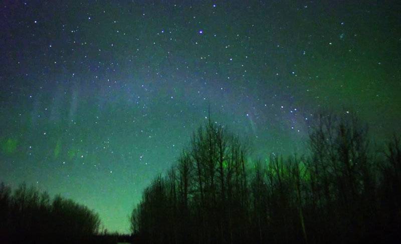

Here is another picture of the event from the same photographer. He says that the photos seen on the web are when STEVE is beneath. The one he captured was way north of STEVE. He also stated that his coordinates were 54.937806 -112.510886 and the other photographers was approx 49.709387 -112.866389.

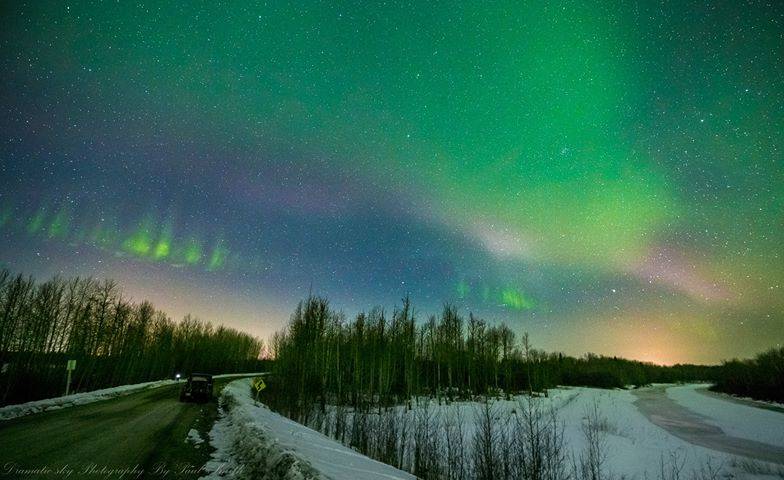

Are these STEVEs always easily visible alongside the picket fence, or is there sometimes a reason the STEVE isn't visible? I only ask because I found several photos on google images that appear to show a picket fence aurora but no STEVE. Here's an example:
Perhaps the STEVE is the glow to the upper right of the aurora?
Thank you for proving my point. STEVE is right there in that picture above the pickets
