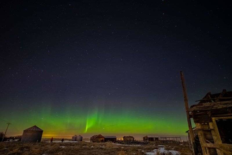

  • #91
@astroscout this was Nikon 14-24mm @14mm

  • #92
Looking north
  • #93
@Siv Heang Tav Both photos failed.I upload Paul's image to test the server and his works fine. Do you watermark your photos?
  • #94
Pics was saved from my Facebook... Let's try again if u can see it.
  • #95
@Siv Heang Tav It failed again. Was the lens set to 14mm or 24mm?

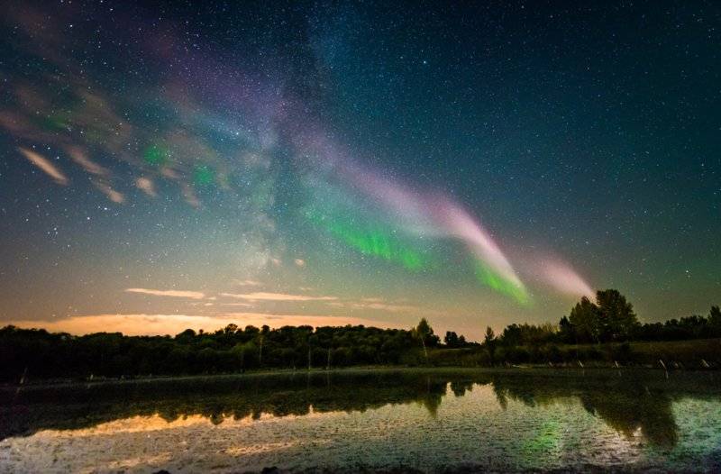

  • #109
@Bill Archer @DaveC426913 I recently found a pair of images that could have been taken just seconds apart. I decided to find the highest altitude star, within the ribbon of Steve, for each photo and use that in the formula that @DaveC426913 used in his calculation.
I first found the highest altitude star in Alan's photo and then Jun's photo by using Starry Night Pro ver 6.
Chi Ursae Majoris (Alan) = 69 Deg
HIP67250 (Jun) = 73 Deg
I then calculated the distance between them using a link that Jozsef Bor sent me that factors in the curvature of the earth:
https://www.movable-type.co.uk/scri...ddfwETl9mb_a_NIw0pOgC6XP1A0CBS2zZFhqKZNun1iwI
and got 120 Km
Then I used @DaveC426913 link to calculate the height:
https://keisan.casio.com/exec/system/1272724233
and I got 173.01 Km as the possible height of Steve.
Jozsef Bor tried to do the calculation using a formula that factors in the azimuth and the elevation of each observer but came up with 347 Km as the possible height of Steve. That result is interesting because if you divide 347 Km by 2 you will get 173.5 Km.
The final result I got of 173.01 Km could be a fluke so we will have to attempt this same method again with the next Steve event to see if we get similar results.
  • #110
Cool. Do you know the lat/long of the two locations?
  • #111
Yes... @DaveC426913 but I was asked not to post it because They were taken near their homes. I decided to just post the distance between them which was 120 Km.
Jozsef and I decided that the best way to approach this is to find an image that is directly below Steve and that one of the stars within the steve ribbon is very close to the 90 deg altitude. We will then use that location as our reference location for the other photos of Steve. We still need for the timestamps to be the same as the one at the reference location.
@Bill Archer I believe that you guys at the University of Calgary have an all sky cam. If the stars can be clearly defined, then we can use your location as our reference if Steve appears directly overhead. Then we could check for the timestamps of the others to see which ones match up. I will then use the same code I used to calculate the height of my Gigantic Jet a few months ago.
I am still planning on using the method I used to get the 173.01 Km result in my previous post. If we can achieve being able to use both methods, then comparing both results should be very interesting.
  • #112
Hang on. Something's fishy.
Both pics are taken from the same side of the phenomenon. (They are both looking North.)
It's an obtuse triangle with one angle being greater than 90 degrees.
Unfortunately, that produces a height of 1,535km!
Here's a visual calculator.
  • #113
@DaveC426913 Could this be why Jozsef was getting erratic results when factoring in the azimuth and elevation?
Is there another formula that we can use in this case?
Jun Wang was located directly north of Calgary and Alan was located southeast of calgary. They were about 120 Km apart.
  • #114
The formula works fine. You just have to examine the geometry and recognize the correct larger angle is the complement (180-73=107)
  • #115
DaveC426913 said:
The formula works fine. You just have to take examine the geometry and recognize the correct larger angle is the complement (180-73=107)
So, is the result I got of 173.01 Km a reasonable calculation?
  • #116
No.
The geometry you used assumes they were on opposite sides of the phenomenon. They are not;
- both pictures see the phenomenon toward the North of the image.
- both pictures are oriented the same way - if one were looking Southward at STEVE, the arc should be flipped (mirrored). Instead, it is merely rotated in the image itself. I corrected for the rotation of the image, but I wouldn't be able to correct for the flip without flipping the image. See top diagram, post 112, above.
So, both observations are - generally - parallel.
The formula takes the inside angles as input. The inside angle of an observer looking North will be the complementary angle - i.e. 180-73=107.
See diagram, post 112, above.
