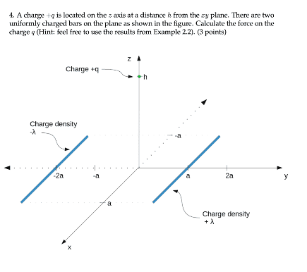

A charge +q is located on the x-axis at a distance h from the xy-plane. There are two uniformly charged bars on the plane as shown in the figure. Calculate the force on the charge q. (Use the results from Ex 2.2)
Eqn. 2.2 is located down below.

Homework Statement: A charge +q is located on the x-axis at a distance h from the xy-plane.
That wouldn't make sense. To match the diagram, the Homework Statement should say "A charge +q is located on the z-axis..."

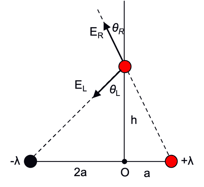

Then break up the algebra into smaller pieces with fewer symbols. Look at the diagram on the right. You have the superposition of the field from the right ##\mathbf E_R## and from the left ##\mathbf E_L.## For the field from the right, $$\mathbf E_R=E_R\sin(\theta_R)~(-\mathbf {\hat y})+E_R\cos(\theta_R)~(+\mathbf {\hat z})$$ where $$\sin(\theta_R)=\frac{a}{\sqrt{a^2+h^2}}~;~~~\cos(\theta_R)=\frac{h}{\sqrt{a^2+h^2}}.$$You get a similar expression for the field from the left. Add the two vectors together, then replace the trig functions and field magnitudes at the very end.
(Edited to fix mislabeled angles.)
