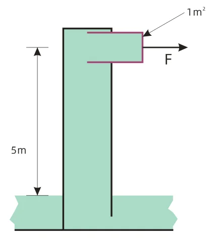

Out of personal interest, I designed a piston-driven water pumping mechanism. However, an extension of this design has left me uncertain about its calculation method.
F=ρgsh
Figure 1 Overall Structure Diagram
Figure 2: Top view of the piston when it is cylindrical​

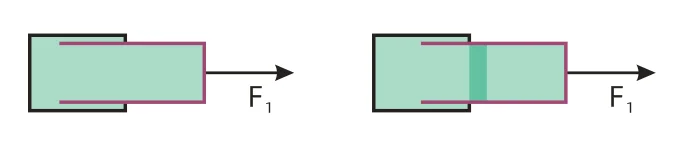

A circular opening is created at a height of 5 meters above the water surface. Inside this opening is a sleeve-type piston with a cross-sectional area of 1 square meter. The piston is pulled to the right at a constant speed. The pulling force is(Figure 2): F = ρshg = 1000 × 1 × 5 × 10 = 50,000 N.

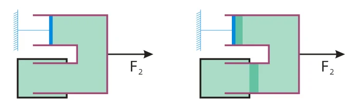

Figure 3: Modifying the structure to incorporate a fixed internal piston​
When I modify the piston structure by adding a fixed internal piston to achieve the configuration shown in Figure 3, does its tensile force remain F = ρshg = 1000 × 1 × 5 × 10 = 50,000 N?
When the pulling force moves the piston an equal distance to the right, the water intake in Figure 3 is twice that of Figure 2.

Then I misinterpreted your last diagram. I now presume it is a top view. That being so, a given movement of the piston raises twice the water than originally, so the force must be doubled.
I also believe the required force is twice the original amount, but the terminal force-bearing area appears to remain constant at s=1 m2, h=5m unchanged, with ρ and g also unchanged. Therefore, I am uncertain how to correctly calculate this value.

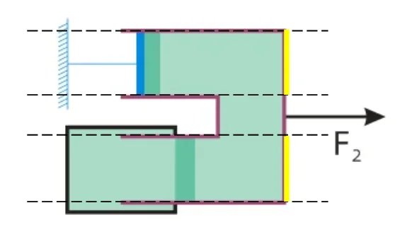

The whole pump casing is moving outward. The second design has double the casing area from the first design. The pulling force is doubled. The work is also doubled. W=Fd.
vdance said:
.. but the terminal force-bearing area appears to remain constant at s=1 m2, h=5m unchanged ...
It has doubled - see the 2 areas indicated in yellow:
Minor edit.

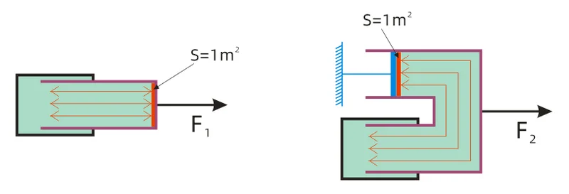

However, both structures also appear to be single-piston, and the area subjected to force remains unchanged (referring to the area of the red part), unless you can indicate another area subjected to force.
Figure 4
*Note: The red bidirectional arrow indicates the interaction between the water and the acting area S.

In my understanding, the area of force application for a liquid is analogous to the point where the rope is tied to the support frame when swinging on a swing. I believe the area of force application shown in Figure 4 may be the correct one.
I'll need to think about your analysis some more before I can fully grasp it.

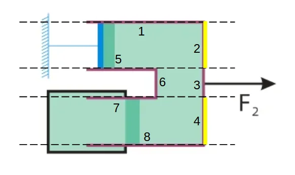

In Fig 4, the water pressure acts upon the casing. The piston in the upper cylinder is not moving but acts as a backstop, so the water does not empty out.
.To see this, make a horizontal cut separating the 2 cylinders, so thar each can move independently, but keep them connected hydraulically with a seal, so they can slide one atop the other without breaking the water column.. A force of 50,000 N will need be applied to each cylinder to counteract the water pressure.

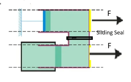

The key is to identify all the forces exerted by the water on the various internal surfaces of the double- piston.
Note that the small blue piston (top left) is assumed frictionless: it exerts a force on the water but no force on the double-piston.
Name the various surfaces of the double-piston 1 to 8, as shown. Surfaces 2, 3 and 4 form the right hand-face of the double-piston.
‘f1’ means the force of the water acting on the surface 1, ,etc.
f1 and f8 act in opposite directions: their sum = 0.
f7 and f5 act in opposite directions: their sum = 0.
f3 and f6 act in opposite directions: their sum = 0
f2 and f4 act in the same direction.
The net force of the water on the double-piston is therefore due to combined forces acting on surfaces 2 and 4 (shown yellow).

Your explanation seems quite easy to understand, and I accept your analysis.
