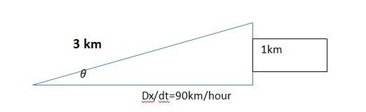

Have you drawn a diagram? You should have a right triangle, with an angle $\theta$ at the spotlight representing the angle of inclination of the beam, a side opposite the angle $\theta$ which is the altitude of the airship, and a hypotenuse (I call it $h$) representing the distance of the airship from the spotlight. You should also have a side adjacent to the spotlight (I call it $x$).
Once you draw this, can you think of a way to relate these quantities using trigonometry?
Okay, good! (Cool)
We need to let the hypotenuse be variable as it is changing...only the opposite side is remaining constant. So let the hypotenuse be $h$. How can we relate $x$, $h$, and $\theta$?

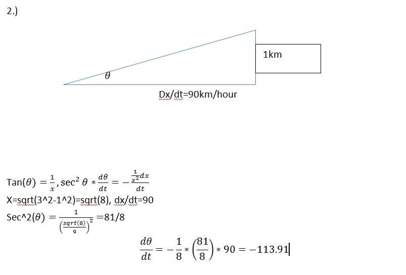

After watching a video or two, and checking the book, I tried it this way, but not confident at all. =/
I agree with:
$$\tan(\theta)=\frac{1}{x}$$
Implicitly differentiating with respect to time $t$:
$$\sec^2(\theta)\frac{d\theta}{dt}=-\frac{1}{x^2}\cdot\frac{dx}{dt}$$
Now, we know:
$$\sec(\theta)=\frac{h}{x}$$
and so we may write:
$$\left(\frac{h}{x} \right)^2\frac{d\theta}{dt}=-\frac{1}{x^2}\cdot\frac{dx}{dt}$$
$$\frac{d\theta}{dt}=-\frac{1}{h^2}\cdot\frac{dx}{dt}$$
Now, we are not told whether the airship is approaching the soptlight or moving away from it, but we see that the sign of $$\frac{d\theta}{dt}$$ is the opposite of the sign of $$\frac{dx}{dt}$$, which means $\theta$ is increasing when $x$ is decreasing and $\theta$ is decreasing when $x$ is increasing. We should just concern ourselves with the magnitude.
Now all you need to do is plug in the given values for $h$ and $$\frac{dx}{dt}$$.
If h = 3, and dx/dt = 90, dθ/dt = -10?

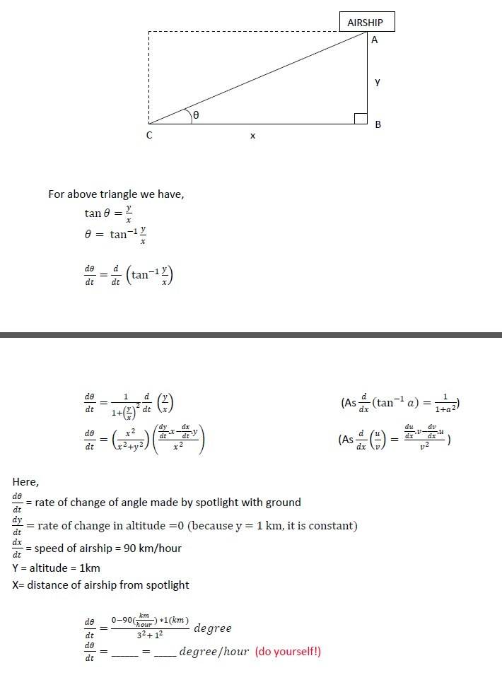

My tutor sent me a (belated) response to this question. His method yields -9, as opposed to -10. Can you see why one answer should be correct over the other?
Your tutor assumed a horizontal distance of 3 km from the spotlight ($x=3\text{ km}$), whereas I assume the true distance from the spotlight, i.e., along the hypotenuse ($x^2+1^2=3^2$).
Your tutor also uses a negated version of the quotient rule, that I found somewhat confusing, but the difference in numbers comes from the difference in interpretation of the problem.
I see it now. Yes, I believe the distance should definitely be along the hypotenuse as well.
