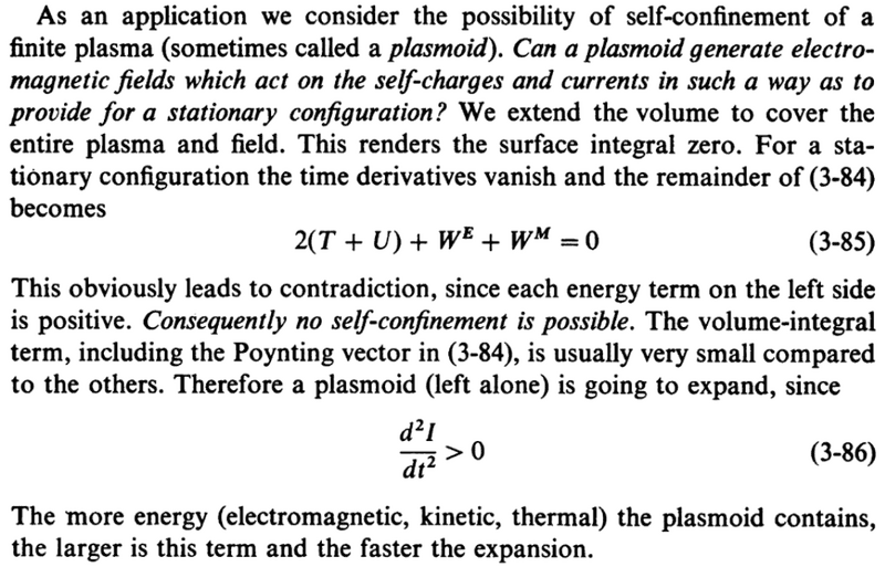

You should study the consequences of the virial theorem (valid in both classical and quantum physics) as investigated in the context of plasma confinement. For example, from G. Schmidt, Physics of High Temperature Plasmas (2nd ed.), pg. 72:
This result is here motivated by plasmoids, but it is more broadly applicable: the virial theorem shows that any localized configuration of fields, charges, and currents cannot hold itself together by any self-forces. It will dynamically expand until it is constrained by external forces.

Suekdccia said:
Just one question: would this apply to systems of any arbitrary size if they contain charges? For instance, electrons forming a Wigner crystal would be also destabilized by the theorem?
No, a Wigner crystal of electrons is stable because it is subjected to an external confining force field: a "uniform, inert, neutralizing background" like a lattice of positively-charged atomic nuclei, or an imposed magnetic field.
