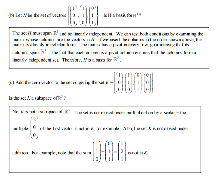

MienTommy
\begin{pmatrix}
1 & 1 & 0 & 0 \\
0 & 1 & 1 & 0 \\
0 & 0 & 1 & 0
\end{pmatrix}
Is this set a subspace of ℝ3
The set must be closed under addition.
The set must be closed under multiplication.
The set must contain the zero vector.
1. It obviously contains the zero vector (column 3)

Edit: I have attached the problem and solution to the thread. I'm not sure how my teacher came across this solution.

Mark44 said:
This is not a set -- it's a matrix.
What is the actual question?
I've attached the problem as an image to the OP. I'm not sure how my teacher came across the solution for this problem. It doesn't make sense to me because the span of that set is a subspace correct?
I responded to what you posted before you edited your post.
The question you asked is very different from what is in the image.
In the image there are two parts. The first part asks whether the given three vectors form a basis for R3. The second part asks whether the given vectors are a subspace. In general, a finite set of vectors won't be a subspace of a vector space, because the axioms of closure under addition and closure under scalar multiplication won't be satisfied.
As Mark44 said, you ask if a set is a subspace but do not give a set of vectors, you give a matrix. Do you mean to treat the columns of the matrix as vectors? The first thing you should realize is that a subspace necessarily contains an infinite number of vectors and this matrix only has a finite number of vectors. Looking at your attachment, there is no matrix but a list of vectors so you simply wrote that incorrectly. But it still is only a finite set and so cannot be a subspace.
