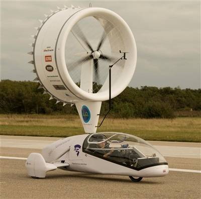

Would building a funnel/cone improve the power output of a given windmill?
Let us say, for example, that we have a windmill with a 3 meter diameter. The windmill would only capture the energy from the wind within the area [approx. 7 square meters] of its rotation (give or take), correct?
So, if you were to build a cone (or a pyramidal funnel) with an area of 28 square meters, wouldn't the energy from the entire area (the 28 square meters) be exerted on the windmill?
(I understand the increase wouldn't be perfect, as there are many variables to consider.)
Also, does the change in angle (thus altering the length) have any effect on the efficiency of the process? (More efficient compression?)
I do apologize if my terminology (and general understanding of fluid dynamics) is not up to snuff. I am only in 12th grade physics - no college craziness :P

You don't have to build a funnel much larger in area than the turbine. You just need the right shape to increase the pressure difference.
It acts similar to the fan shrouding below, but it's not quite the same thing:
https://www.youtube.com/watch?v=gChp0Cy33eY

What the large cone effectively does is bring most of the moving wind it captures to a stop, with some of the wind flowing through the turbine and some of the wind flowing around the outer edges of the cone. There's a slight increase in pressure due to ram effect (dynamic pressure) when stopping the wind, but it's not much at normal wind speeds.
I'm thinking that just increasing windmill diameter somewhat will have more benefit than using a large funnel (cone).

It has a similar shape, but the flow is generated differently of course. The shroud has the profile of a wing, and creates under-pressure on the inside, which sucks more air in.
