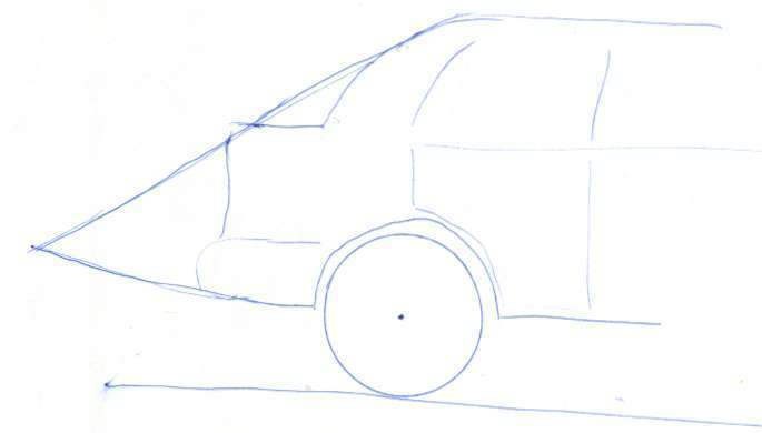

- speaking of aerodynamics, small and big cars have very similar frontal area surface and drag coefficient. does that mean that it would be easier to put all this compressed air into a bigger car (more space for tanks), since a bit heavier car wouldn't consume that much more energy?
- could i reduce drag by installing some weird panes on the back of the car (something like horizontally turned pyramid or a cone)?

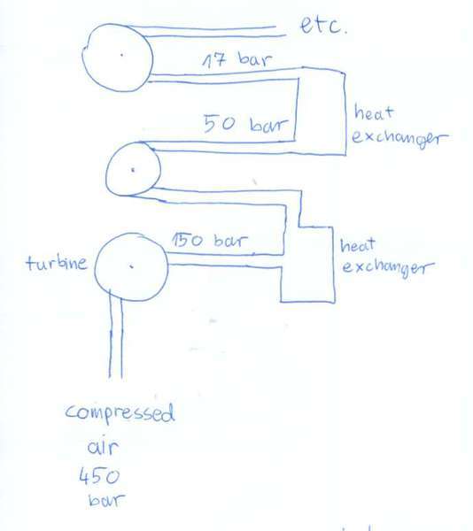

- since a lot of fresh air would be needed to warm cold, expanded air between expansion stages, i could make a long and huge pipe to the rear part of the car, ending as huge exhaust pipes somewhere in the middle of the back of the car (vertically). would that contribute to lower drag coefficient?
- what's the efficiency of existing air motors? can they be connected in series, let's say each stage would expand air volume 3 times, so 6 stages would do the job. would the first motor (the one working on 450 bar) actually work with such pressure?

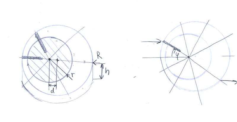

- i could use a vane pump-like air motor. many motors with different radiuses could be connected to a single shaft, and a computer would decide which motors would the air pass through. i actually already have all the calculations for that motors made (dimensions and dependent torque), my main concern momentarily is sealing. a itzy-bitzy vane pump (a 10 cm diameter (4")) and to put in 450 bar...

2- The frontal surface area and drag coefficient of you car are important. A small increase in length probably won't damage your total drag too much. Just remember that a difference in drag coefficient from 0.25 and 0.3 (seemingly small) is a 20% increase in drag. And more and more important as your velocity increases
3- You could perhaps reduce the drag due to vortices that are generated on the trailing edge of your car, but that would require some serious research into the flow profile of the car you choose or design. Usually adding anything will increase the drag.
Adding length and tapering the back down to a point is acutally much more beneficial than reducing the frontal area on Cd.
The main drag on a car is pressure drag from separated flow By making it longer you can reduce the angle of the taper and therefore keep the flow attached to the surface. This is the reason why you see sports cars with no rear window wipers and why many roof box/racks with sloped fronts are more efficient when put on backwards.
The ideal aero shape you want for a car is a long thin teardrop. But that looks both silly and is impractical for road use.

check out the attachments. if i managed to make the added "teardrop rear" retractable, then it would activate at speeds higher than (some speed i guess :smile:) and retract during city driving.
i alse attached a skecth of supposed multi-staged expansion motor. note that turbines should either be of different sizes on the same shaft or i'd use sort of a trick, e.g. this one:

Ah the attachments are working for me now. So you are running it from a set of turbines not using the compressed air to acutate a piston? Interesting.
Are you goiing to be running the LP turbines down to 1 bar? And how is this going to work, are you thinking directly driven or is it going to power an electric motor?
i thought a turbine would actually be a vane pump, just inverted - i'd attach all of them to the same shaft and make their sizes vary, so that the smallest space in the smallest turbine would be 450-times smaller than the biggest one in the biggest turbine. an engine like this would be ridiculously small and would have huge torque (in the beginning, at 450 bar). gor lower pressures, i'd add some bigger turbines to maintain approximately constant torque. a computer would control valves that would turn air flow into desired turbines.

As I see it there are some huge, real problems with compressed air:
1) Safety. A compressed air car made from carbon fiber will never pass FMVSS safety standards for crashes. Also, compressed air at those pressures make very nice bombs. Not that gas cars can't explode, but if you rupture a gas tank, it won't immediately explode. A compressed air tank at 400-500 bar will.
2) Filling rate required: If you try to fill a compressed air tank quickly at those high of pressures, you better have supplemental cooling for the tank. If you don't, I don't know of many people who would be happy with a day long refill of their tank when the best you're looking at range wise is a couple of kilometers. Also, the notion of pulling up to a refilling station is ludicrous. I wouldn't want to be anywhere near a tank when it is being filled to high pressure. The tanks should be submerged in water when they get filled. Look for any accident report of a scuba tank exploding and you'll see why this should be mandatory for filling.
3) Heat Exchangers: Because you need a heat exchanger in the system, you are limited in the delta t between the inlet and outlet temps. This drives the size and the weight up.

3) Heat Exchangers:
you probably meant temperature difference, right? i don't know why is the problem here. air, expanded to three times the starting volume, can quickly reach temperatures well below -50°C, and 50 or 70 K is a difference, large enough to have a reasonably small heat exchanger.
