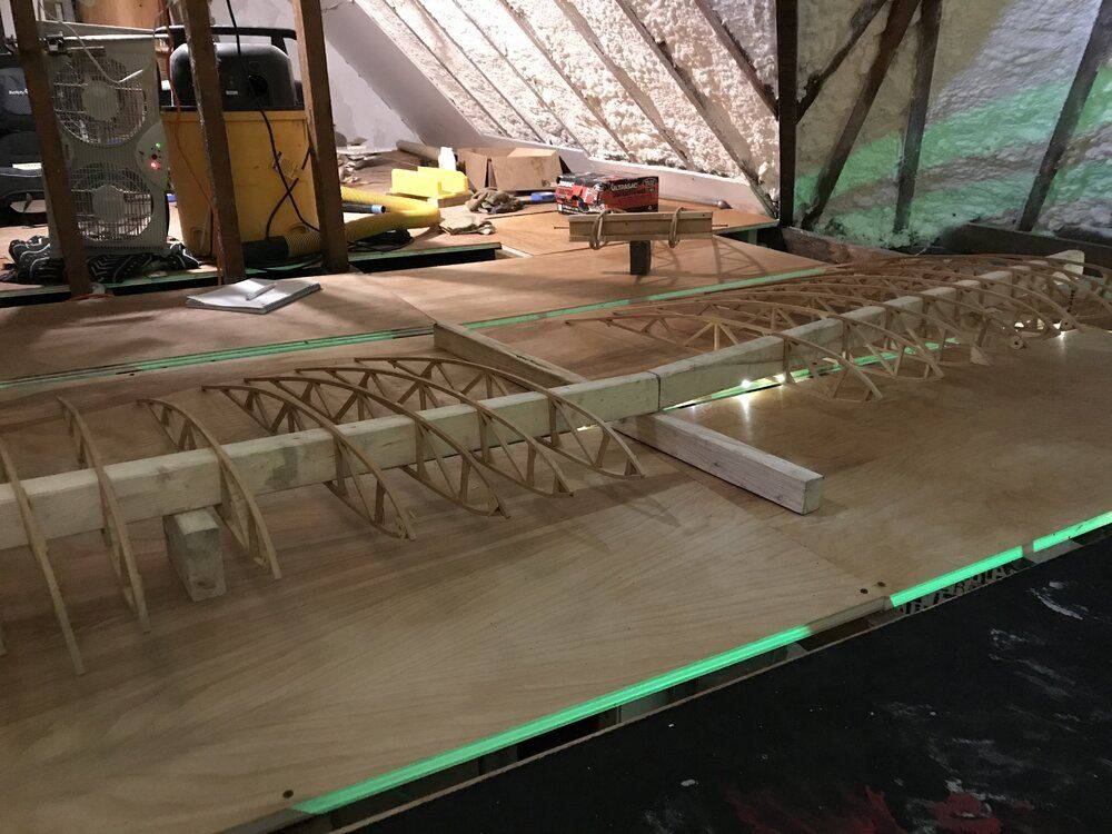

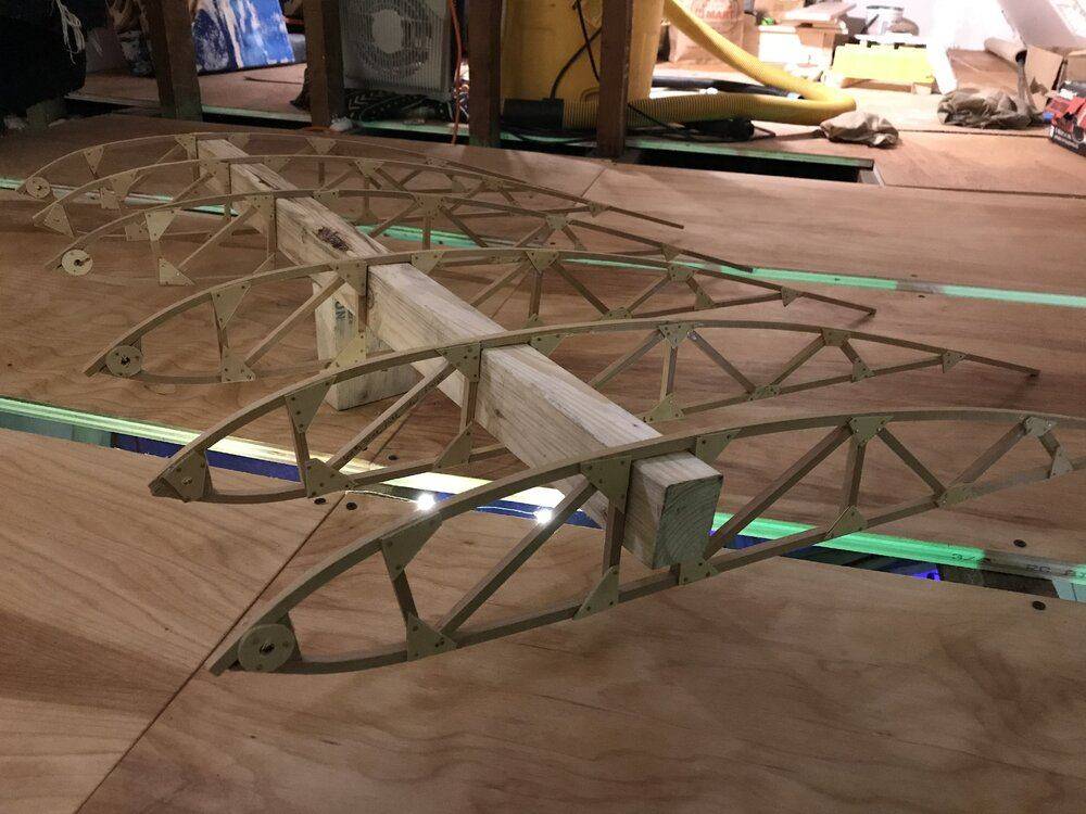

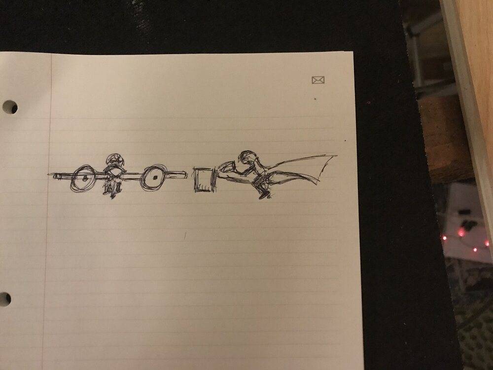

I am working on a wing in ground effect racer. I’m a glider pilot with an engineering background. I want to create a very small very simple craft that will operate in the ground effect regime. Think pod racer from the Star Wars prequels. Most simply it’s a single wing in back that will be tailored for WIG and twin shrouded props in tractor configuration in front that will also counteract the main wings pitching moment.
When I talk about the scale of the craft I like to say it’s like a BMX with surfboard sized wings. I have included a drawing that shows a rough plan form and scale and also shows how the pilot will ride in a semi shrouded open cockpit. Like riding on a motorcycle with a fairing and small windshield.
The goal here is to create something super simple and dynamic for short WIG races. Like 2 minutes flight time. I want lots of folks to be involved. And have a craft that teams can put together for less than 1000 USD. The entire design will be open source so people can modify it. And maybe become part of an advanced STEM course. The flight control software is currently running on an arduino nano with a 6050 IMU and will be part of the hackable open source system that I hope folks will want to get into.
There are still lots of things to think about but if you check the picts below you can see I have started building the wings. These wings are to scale but the final wing will be a much simpler molded foam core with fiberglass skin. One thing that is on my mind is the power. The engines will control yaw with differential thrust but I want the safest and most efficient system. I have been looking at large RC electric motors and EDF units. The EDF units appeal to me because I think they might be safer, as far as mitigating prop strikes. I would need 4 or 5, 90mm EDFs clustered on each side for about 60 lbs thrust which would hypothetically be a thrust to weight of about .25 which is small but I think it would be enough in ground effect. Another option would be something like a Rotomax 100cc electric motor that puts out about 7000 watts.
Anyhow, any thoughts? I’ve been thinking about this for quite a few years and am at a good point in my life to do it. So here we go.

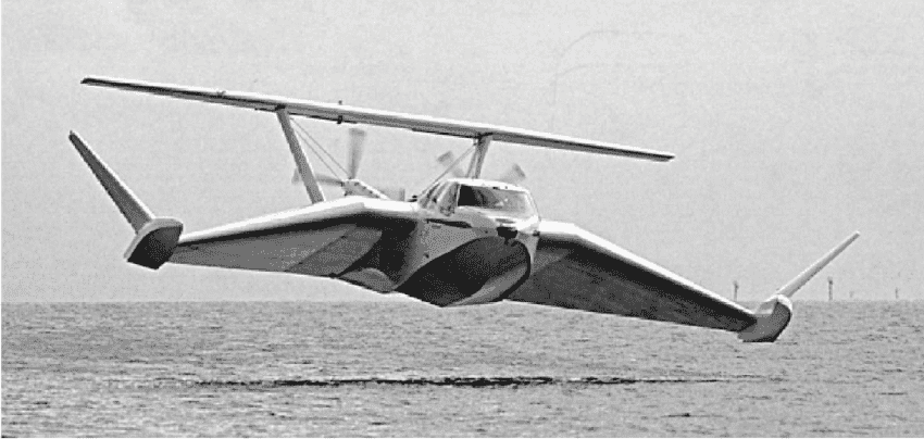

Fun project. What is your projected speed and height of the wings above the ground? Given enough room for your legs and for banking turns, will you really be in the Ground Effect? Unless you are going at airplane type speeds, it seems like your wings will be out of the Ground Effect.
https://www.researchgate.net/profile/Tomasz_Abramowski/publication/228651914/figure/fig10/AS:668618429845514@1536422464598/A-WIG-craft-recently-introduced-to-operation-by-Pacific-Seaflight-on-Alaska.png

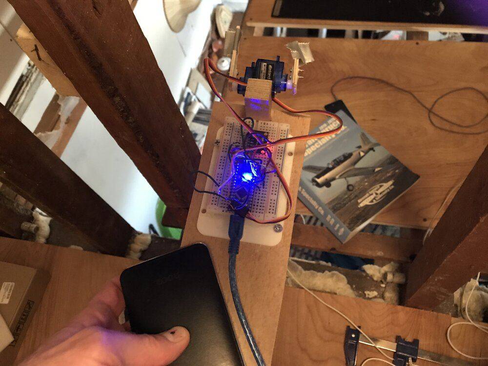

Yes, I have a model...as mentioned before I’m running an arduino with a 6050 IMU. It’s working as a servo controller right now for flaperon stability only and is a baseline for establishing level flight. Currently the model is non flying but it is stand alone and fairly robust. It is based on a quad copter stability system from Brokker.net.

I’ve attached a photo of my working flight computer not much to look at but it works and it exists.

Yes, I know this picture. While the main lifting wing is in ground effect, the horizontal stabilizer is not. In my extensive analysis, you want pitch stability in the ground effect regime as well. Some of the massive soviet Ektaplans use canard for pitch stability and it’s what’s needed for the efficiency spiral I spoke of in another reply.Speeds I’m looking at; stall of 30 mph and not going much faster than 60mph. My all up weight of craft and rider I hope to be 250 lbs. Thats why I’m building a full scale prototype along side the models. Because I need to be able to keep this light and simple. Again a BMX with surfboard sized wings. I don’t think I risk leaving ground effect since true flight requires even more power and less drag. My wings are a high lift profile. Max CL is 1.2 with no flap. In ground effect I expect a CL of 1.8. My Cm (pitching moment) is quite high though. 0.08 so the canard propulsion is crucial to keep the nose up. Wings have a 12 foot span and a 2.5 foot cord which gives us a wing loading of about 5lbs/ft2.
edit: Forgot this bit...max altitude will be about 6 feet with sporadic moments outside of that for some ‘style flying’. The BMX with wings metaphors I hope to carry over to all aspects of this project. Not just a small cool aircraft but the flair and community of BMX as well.

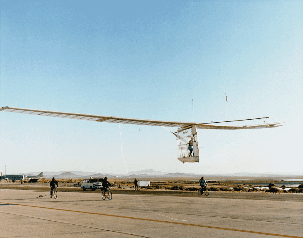

I think you should compare your plans with The Gossamer Albatross and the Gossamer Condor. There should be many similarities, and if you get lucky, you might not need as much power as you think.
edit: and perhaps you can get by with less airspeed than 30 knots. I always always work first on reducing demand, and second on providing power.
View attachment 274905View attachment 274906

How about starting with an unpowered glider going downslope over a forgiving surface. There's a good reason that the pioneers began at Kitty Hawk. When you get that design working well, then start adding weight+thrust in a propulsion system and see how close you can get to level flight.
I say that because (a) Initial safety. (b) I think of the very small power needed for those Albatross (15 knots and perhaps 150 watts). I suspect that you may be aiming too high on the power&thrust needed. It would be preferable to start low and scale up, than start too high on power&thrust&weight&airspeed and scale back. As you know from flying gliders, the heavier the aircraft the higher the airspeed and the higher the safety risk.
Have you asked around in the hang-gliding community? I wonder if anyone took a Rogalo wing hang glider and tried modifying it with power and a propeller.
I just thought of another way to estimate the power and airspeed needed. Use a winch launch. The winch power is easy to measure. You could measure the L/D ratios at different airspeeds and different vehicle weights in a series of experiments. If you did it over soft sand, and limited the altitude to 2m, it would be pretty safe. When you have the data in hand, you'll know how much power & weight you need.

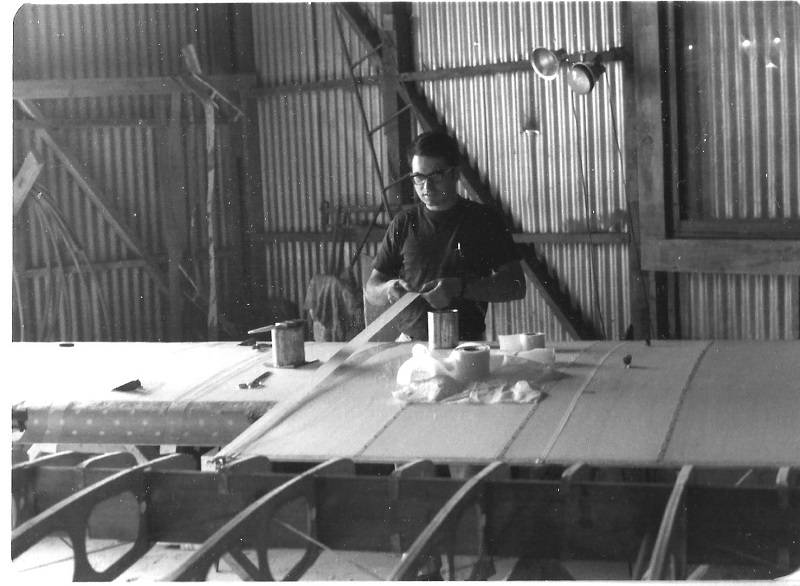

I highly recommend that you join the Experimental Aircraft Association. And make use of their forums and builder resources, especially the Technical Counselors: https://eaa.org/eaa/aircraft-building/BuilderResources. The Technical Counselors will help you build to aircraft standards, then point you to the EAA Flight Test Manual when it's ready to fly.
I say this because I have experience in this area. Me, about 1976, rebuilding the wings of a Taylorcraft BC-12D:
Jim
EAA Member #92859

I agree with you 100%. One of the reasons I built my wing ribs first is to learn if I can’t build those, then I can’t build and airplane. Another super wise piece of advice I have listened to is ‘don’t buy your power plant until your fire wall is done.‘ And ,,,, ‘do you want to fly or build?’ That’s one people talk about a lot. Because for the most part builders don't fly because they rarely finish. Especially scratch builders.

So to get back to the point. When I started building wing ribs, folks thought/advised that those should be the first thing to build to get a feel for what lies ahead. There was no, what sort of flight computer are you using? But that’s the core of the new breed of aircraft, not just drones but the slew of air taxis people are talking about online.
