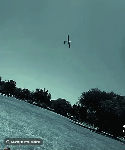

Hello,
While dynamic soaring 3 of my rc ships seem faster in left tilted loops with left wing washin not just the tip.
No rolling tendency is noted why is this. This is slow speed just 70 mph.
I wonder what would happen with this setup on a large ds location.
Is a tilted loop the same as a vertical loop.
Why wont it roll right during pull up

.Scott said:
You mentioned "wash in". I think what you are saying is that your RC models use wing wash-in control instead of ailerons.
Or perhaps the OP is referring to reverse washout.
I have trouble parsing that post though. Is the question about airspeed or vertical speed in the thermals? Or something else perhaps? I assume "left tilted" means "banking left".

.Scott said:
The overall context is "Dynamic Soaring"
That is also what I thought until you mentioned thermals and the text "thermal soaring" in the OP picture. But it sure makes more sense with dynamic soaring.

No I'm using ailerons...just wondering if this work at higher speeds without a rolling out..... I I talked to who set record they theorized it would roll n crash above 200mph....

The right wing is warp free. Both wings are positive relative to the stab. Left wing is even more positive. Left turns n thetmaling are more effecient
ds3227 said:
The right wing is warp free. Both wings are positive relative to the stab. Left wing is even more positive. Left turns n thermaling are more efficient
To be clear, you have made left turns more efficient when thermaling by making the plane asymmetric.
