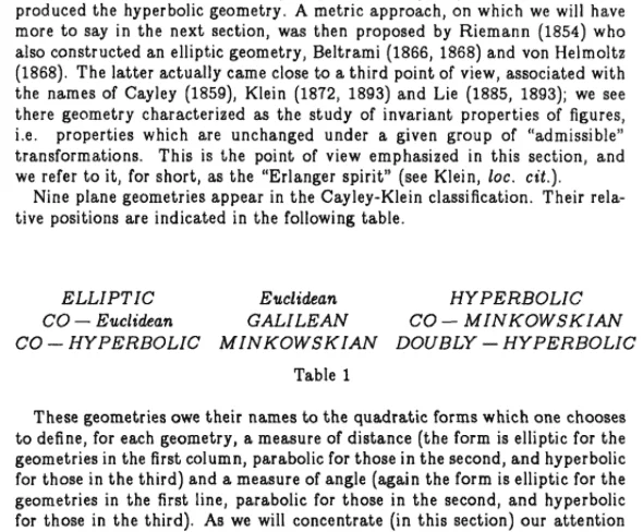

One should also mention Felix Klein who formulated the Cayley-Klein geometries (1870s)

Emch said:
Torretti said:
From Torretti's Philosophy of Geometry from Riemann to Poincare, p 129 [via Google books]
In his posthumous Lectures on Non-Euclidean Geometry (1926) Klein briefly examines the other four degenerate cases. He does not pay much attention to the resulting geometries because angle-measure in them is not periodic - a fact that, in Klein's opinion, makes them inapplicable fo the real world, since "experience shows us that a finite sequence of rotation [about an axis of a bundle of planes] finally takes us back to our starting point". [Torretti references Klein's lectures [in German], p. 189]
I believe this is referencing the fact that the Galilean and Lorentz Transformations are not periodic.
It's possible that Klein (in the 1890s) in his study of hyperbolic and elliptical geometry could have uncovered, by analogy, the mathematics of special relativity before Einstein (1905) and Minkowski (1907).
I think it's fair to say that all of these were maybe one or two steps away from a correct formulation of special relativity.
