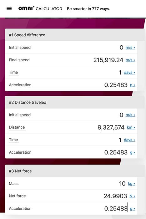

If we were in a hypothetical galaxy of the size and overall mass of the Milky Way that did not have a black hole at its center, then the velocity of an object that fell freely from a distance similar to that of the solar system, to the barycenter, relative to a stationary observer at the barycenter, would be much smaller than the speed of light. The simplest way to get a rough order of magnitude estimate of that speed is that it will be the same as the orbital speed around the barycenter of an object in a free-fall orbit at the same distance from the barycenter--in other words, around 215 km/s. As above, there isn't really a well-defined "speed relative to Earth" for an object at the barycenter, but again, a rough estimate would just be the vector sum of 215 km/s in two perpendicular directions (radial along the Earth-barycenter line, and tangential to that line), which is 215 times ##\sqrt{2}##.
To calculate the initial acceleration of an object in free fall (no orbital motion) from the height of the solar system towards the milky way's barycenter, can I use a formula based on:
Circular Orbital Speed at Earth Distance From Solar System Barycenter = A
Instantaneous Acceleration of Object in Free Fall at Earth Distance From Solar System Barycenter = B
Circular Orbital Speed at Solar System Distance From Galactic Barycenter = C
Instantaneous Acceleration of Object in Free Fall at Solar System Distance From Galactic Barycenter = D
^Trying to solve for D
You would just use the standard Newtonian gravity formula, plugging in the mass of the Milky Way and the distance from its barycenter. (Strictly speaking, it would just be the mass of the Milky Way that is closer to the center than the solar system, and there might be some correction because the Milky Way is not spherically symmetric, but these corrections are small and hard to estimate anyway. It depends on how accurate you want your answer to be.)
