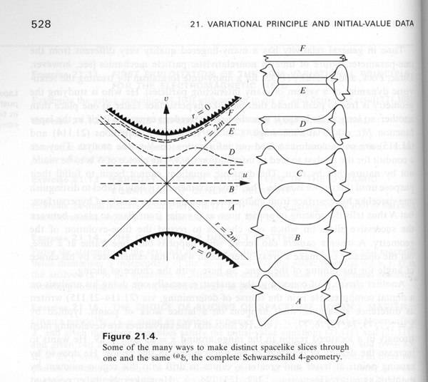

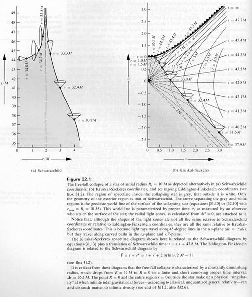

On the Penrose diagram t=const curves are parallel to the r=2M horizon, so e_t is orthogonal to it, isn't it?
What are the integral curves for [itex]\partial_t[/itex]?
No, a t=const curve would have constant t but varying r, while the horizon has constant r at all values of t, so the horizon is orthogonal to t=const curves and parallel to the t-axis in Schwarzschild coordinates.
At any event p, [itex]\partial_t[/itex] is tangent to the [itex]r=[/itex]constant curve (parametrized by [itex]t[/itex]) that passes through p.
Hi Jesse. The comments that I have made are with respect to a diagram for Kruskal-Szekeres coordinates. For such a diagram, what are the possible values for Schwarzschild coordinates "on" the horizon"? I have used scare quotes, because Shwarzschild coordinates don't actually cover the horizon.
