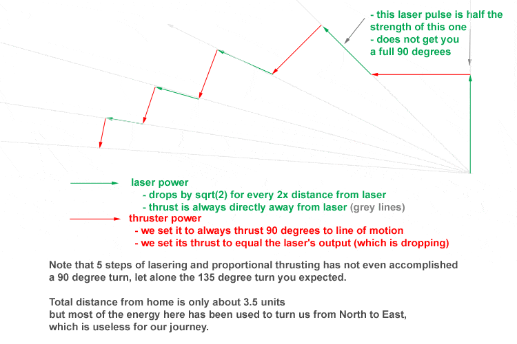

I respectfully disagree. Moving the sail away from the laser isn't like moving it against an energy gradient (gravity or electromagnetic field). In theory you could put the sail on a -very large- wheel and achieve the affect I described. Something you couldn't do if the force was an energy gradient.
Here is how I approached it. I draw a force with magnitude and direction of a 100 Newtons. Now draw another force with a magnitude of a 100 Newtons and at 90 degrees to the first force. The resultant force will be at 45 degrees and 141 Newtons.
Now repeat, but this time use 141 Newtons for the force to be applied at 90 degrees. The resultant force is 199 Newtons.
We are now traveling at 90 degrees from our starting trajectory with a total force of 199 Newtons.
If you repeat this 6 more times (45 degrees each time) the result is to have the craft with a resulting trajectory of 360 degrees from its initial trajectory- or equal to it's initial trajectory. But now the resultant magnitude force is 796 Newtons or a 1 kg craft that has been accellerated to 796 m/s.
Or is my logic faulty?
OK, you've used 200 units of energy, but are now only 141 units of distance form home. 59 units have been split between
- spinning your trajectory around the solar system
- moving you faster away from home
Unfortunately, only one of of those accomplishes anything; the other is completely wasted.

With every turn, you put some oblique thrust from your thruster into useful motion away from home, and you waste the rest, uselessly rotating 45 degrees around the solar system.
At the same time, with every turn, your laser power is dropping in proportion to the square of your distance from home.
Note that this last part has nothing to do with your technique. Even if going in a straight line, for every sqrt(2) increase in your distance, your last power drops to half. No way around that.
You would do better to simply point your thruster in line with your motion and stop wasting it.
Have a look at this. It's a little oversimplified, in that it is mixing velocity and displacement, but the principle is there.
No matter how you cut it, two things happen:
1] the farther you are from the laser, the less power it provides
2] Any energy from any source that is not devoted to moving directly away from home to our destination is energy wasted. (In this case, it is the oblique angle of the thruster.)

He wants to use the thruster to keep the sail closer to the laser, where it has more power. His idea is to give the ship as much speed as possible before it leaves the effective range of the laser.
He doesn't see that you don't get anything for free.
I imagine after he examines the diagram I drew, he'll see that his geometry is off. He thought each 45 degree leg of the journey would be identical in length. He did not account for the fact that each leg is not as effective as the previous leg because the ship is getting farther from the laser.
