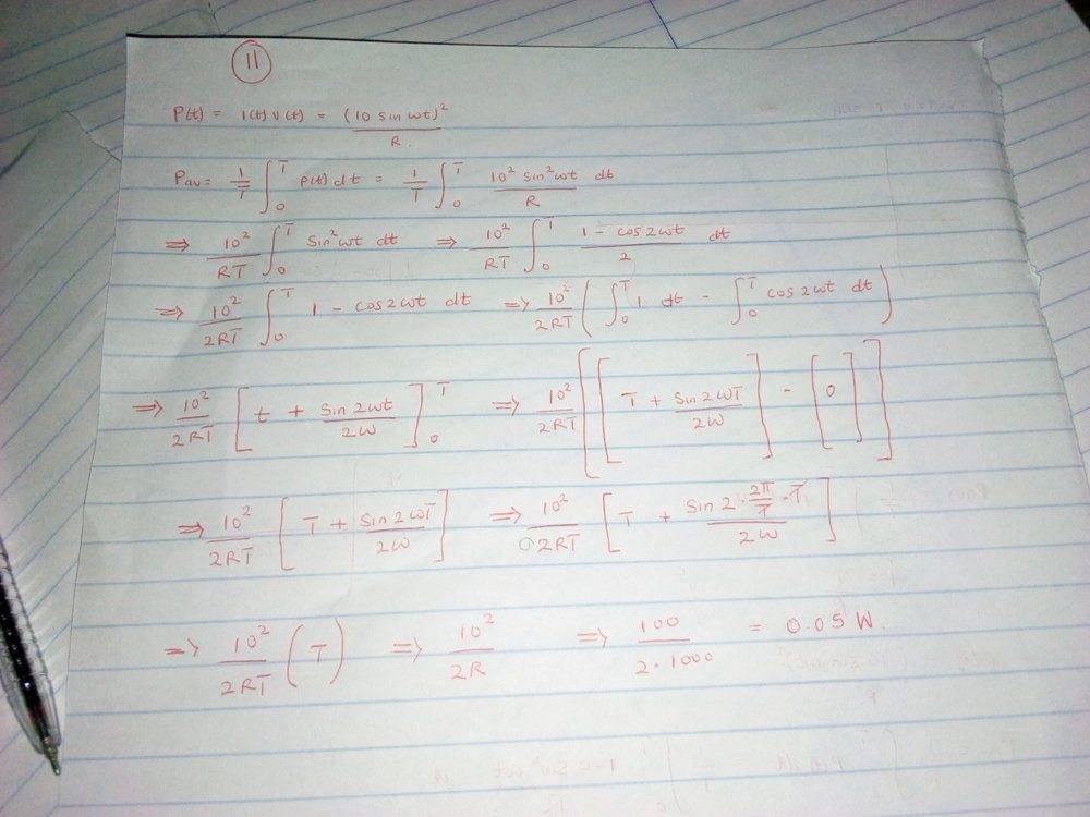

A sinusoidal voltage source v =10sin(ωt) Volts is connected across a 1 kΩresistor.
1. Make a sketch of p(t), the instantaneous powersupplied by the source.
2. Determine the average power supplied by the source.
3. Now, suppose that a square wave generator is used as thesource. If the square wave signal has a peak-to-peak of 20 Voltsand a zero average value, determine the average power supplied bythe source.
4. Next, if the square wave signal has a peak-to-peak of 20Volts and a 10-Volt average value, determine the average powersupplied by the source.

I am able to do the second question, but I don't understand the other part. Thanks

The photo is pretty hard to read. Do you have access to a scanner? Better yet, have you looked at the LaTeX tutorial that I pointed you to? :smile:
