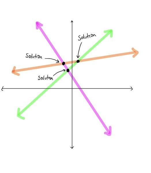

According to my text, a linear system of equations is a problem described by two or more equations in two or more variables. Now the individual equations have infinitely many solutions, however, the system of equations is said to have either exactly one solution (one point of intersection between the lines) , no solution,(no points of intersection) or infinitely many solutions (the equations lie on the same line).
Now here is my confusion- if the solutions to linear systems of equations are limited to these three options, and linear systems of equations can have more than two equations, how is it possible that we can't have something like 3 solutions?
Here is what I mean. Three different lines corresponding to three different equations which seems to imply that there are three points of intersection.

I don't understand the picture you've posted. If it is supposed to be in a 2-D space, then you've shown a case where there are no solutions -- i.e. no points that satisfy all 3 lines simultaneously. If it's supposed to be a 3-D space, there should be another axis.

All three points you drew are solutions to two out of three equations. If we speak of a system of linear equations, all three are meant to be satisfied at a time.

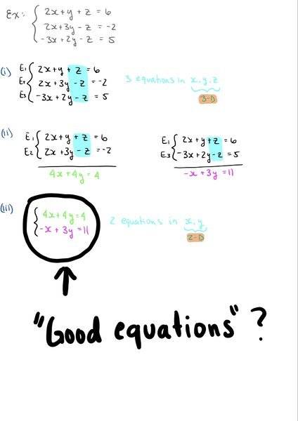

(i) What do you mean by this? I understand that with two variables, we are working in a plane of two dimensions. Solutions to these types of systems will be points. And with three variables, we are now working in a 3-dimensional space and solutions to these equations are lines?? So from what I can tell, the number of variables dictates the number of dimensions we're working in.
(ii) So in my reading, a linear independent equation is where a set of vectors cannot be defined in terms of each other. I'm not sure what to make of this. Could you please elaborate?
(iii) But isn't saying there are infinite points in the plane much different than saying that there are infinite or finite solutions? There are infinite points on a line but it is possible that two lines, with infinite points, have only one solution.
(iv) I'm not understanding what you mean when you refer to good equations, and one dimension lower.
Got it! So for it to be a solution, it has to be a point on all lines, not just an intersection point of any lines.

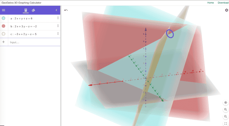

So for the previously given system of equations (in the pic) I went and graphed them. Where I drew the circle appears to be a point of intersection which is (-2,3,7). So is it true that we can have solutions in three variable equations that are points or lines, depending on the orientation of the planes?Edit: I've found a system that intersects in a line. As seen in additional image.

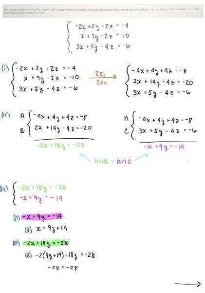

I can see from the first picture that you started out with the equations of three planes in space. Then you intersected the first with the second and the first with the third. Both gave you the two intersection lines of planes. And both lines are neither equal nor parallel, so they intersect in the now (x,y) plane. From there I cannot read your light blue writings anymore.
This is the correct result, although your handwriting in picture 1 didn't look as if you had calculated this to the end. The last intersection of your two lines in the (x,y) plane appears to be missing.
Not sure I understand you correctly. You can have points or lines for different examples, but not for the same set of equations. But in general, there is also no solution at all possible, an entire plane, or for the equation ##0=0## even the entire space. It depends on the set of equations, because they determine the orientations.
You started with three planes ##A,B,C\,##.
Then you calculated the intersection lines ##b=A \cap B## and ##c=A\cap C\,.##
Now you have two lines in space. However, you are still on plane ##A## as ##b## and ##c## are in ##A##. So the next intersection will take place within plane ##A##. And two lines in a plane can either be parallel, coincident or intersect in exactly one point, as in your case.
In general, two lines in space don't need to intersect even if they aren't equal or parallel. They still can be skew in space. An option they don't have on a plane.
So here, I used the elimination/addition method to eliminate the variable ##z##. The main purpose of showing that, was to clarify what was meant by "good equations". I did a lackluster job of framing my question correctly.
So when I intersected ##E_1## with ##E_2## and ##E_1## with ##E_3##, I ended up with two non-equal and non-parallel lines as you stated. Now I have these two equations, yet the original system of equations had 3. These two equations, the ones labeled in green and pink, are they what are considered the "good equations"? And what is meant by the term "good equations"?

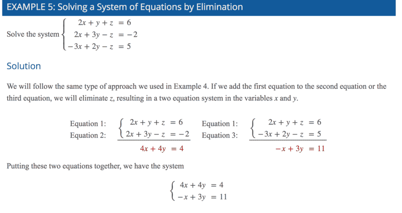

So let me see if I understand. Because I know how to do that calculation to get the solution for the most part, but that means squat and I want to know what I'm doing to what.
(i) So I started off with a system of equations in three variables. In other words, I am given three planes ##A,B,C## and these are represented in three-dimensional space.
(ii) By using the elimination/addition method (or substitution method would work as well), what I'm doing is intersecting two planes to get a line. In this case, I intersected Plane ##A## with Plane ##B## to get line ##b##, and I intersected Plane ##A## with Plane ##C## to get line ##c##.
Now I have two equations in two variables that represent two lines in two-dimensional space. These lines are neither equal nor parallel, so they intersect at some point ##(x,y)##.
(iii) By using the elimination/addition method once more, I can drop these two variable equations down to a single variable equation to solve for one coordinate of the point of the lines' intersection. I can then plug this value, back into one of the two variable equations to solve for the other coordinate to which the two lines intersect.
(iv) In this case, I now have the value of ##x## and the value of ##y##. Now I can plug both of these values into one of the original three variable equations in the given problem to find the third variable ##z##.
(iv) I now have ##(x,y,z)##, and in this case, this represents a point in 3-dimensional space to which the three given planes intersect simultaneously.
I have no idea. There are several ways to solve such a system. I like the substitution method. Every equation sets a constraint on one variable, such that at the end all three are determined (or not, if there are redundancies). So I know the three methods you have mentioned, and one which uses matrices. But I never have heard of "good equations". The difficulty with these addition- and substitution methods is, that you could run in circles and using implicitly the same equation again, which would lead to false results. So I can only guess, that by good equations are those meant, which aren't combinations of the others. E.g. if we had ##x+y=1## and ##2x+2y=2## we would have only one which counts., not two. And this example can be made less obvious if we have more equations, but still dependent. I wouldn't spend much time on a term which you will never need again, as the correct terms are linear dependence, resp. independence.

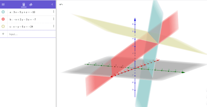

Okay another question which is pretty similar to the last, again this is accompanied by a picture of my work (don't mind if you can't see the light blue. that color is just side notes for myself).
Now in this system of equations, I am given Plane ##A##, Plane ##B##, and Plane ##C##.
In using the process of elimination, I find that in intersecting ##A## and ##B## as well as ##A## and ##C##, they are the same line.
Now, since ##A \cap B = A \cap C##, I am inclined to say that the system is dependent. That is, all planes intersect in a line.
However, so far, we haven't taken into account the relationship between Plane ##B## and Plane ##C##, and if their line of intersection is not equal to that of ##A \cap B = A \cap C##, then the system is not dependent.
