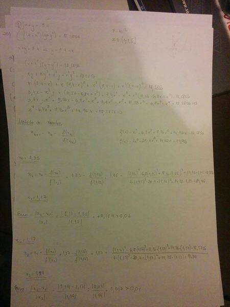

So, now I have
(x+x2)(3.4-x+11.56-6.8x+x2)-18.5856=0
f(x) = (x+x2)(x2-7.8x+14.96)-18.5856
f(x) = (x+x2)(x+3.8676)2)-18.5856
f'(x) = (1+2x)(x+3.8676)2+(x+x2)(2x-7.8)
i(x)= x - f(x)/f'(x)
i(1.25)=0.5325 (what is wrong, because the problem tell me that the lowest number is in [1,1,5]
i(0.5325)=0.61324
i(0.61324)=0.64672 ... and it's converging for something that it's wrong. Any Idea where I might have messed up?

You write ##3.4-x + 11.56-6.8 + x^2 = (x+3.867)^2##. That is false: ##(3.4-x) + (3.4-x)^2 = (3.4 - x)(4.4-x)##.
So did you manage to conclude this exercise, Lucas ?
Yes I did! Thanks everyone for the help.
I agree with the 1.17
For the 1.19 I get 1.1992 and the residu is then -0.007 which is < 0.01 -- you should use one more digit (or a calculator or a spreadsheet).
Your residu is > 0.01 so you are not done yet !
Note that the 'error' for ##x_n## is ##f(x)## and not ##|x_n - x_{n-1}|\over |x_n|##
