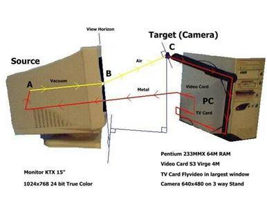

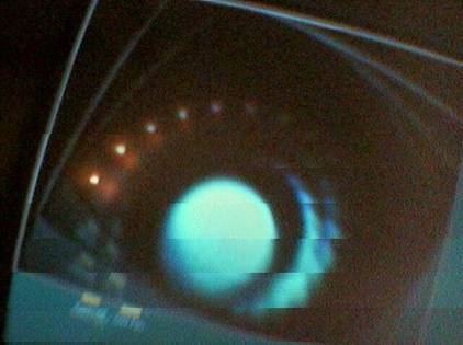

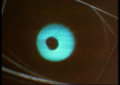

I just changed my avatar as it is a screen capture of an optical feedback loop in the process of becoming a consistent rotating ring. To make this ring cover the centre of the circle for long enough to effectively introduce a shadow into the feedback loop without destroying the pattern. I have only done it twice before nearly 20 years ago (using my finger) and the amazing thing is that there are 2 sets of tiny 'waves' running in different directions around the inside and outside of the ring.
