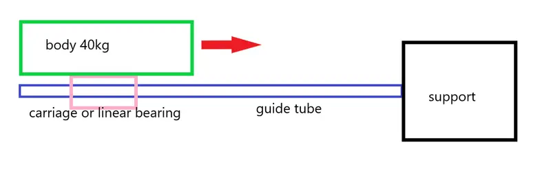

Sorry, I will take into account your requirement regarding ChatGPT and similar systems. Regarding my task:
a body weighing 40 kg moves along linear guides that are fixed to a support. We ignore the friction force at the moment. The body has an initial velocity of 1.6 m/s. This body must be stopped in 0.1 s. For the minimum distance. At the same time, the force of impact on the support should not exceed 100 N. According to calculations, the braking force should be approximately 640 N. Is it possible to somehow "hide" the impulse from the body to the damper inside the system with minimal impact on the support and dissipate over time?
No diagram.

horizontal guides. The task is to come up with a damper that will perform braking in a specified time and with the transfer of the minimum possible force to the support.

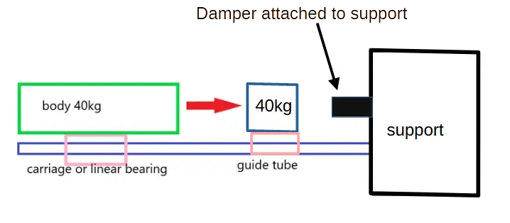

If you have the body collide elastically with another object of equal mass, it will transfer all of its momentum to the object in just the collision time. Then you could bring the object to rest over a longer time, so that the force on it never exceeds 100 N.

Yes, the initial body comes to rest quickly, which is what the OP wants. The object which absorbed the momentum can then be brought to rest more slowly.

To follow-on from @vela's suggestion:
where the damper is a hydraulic buffer (available in a wide range of sizes and damping).

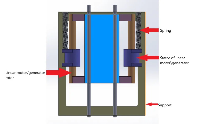

Thank you for your answers, below I have drawn my concept of such a damper. A linear generator-motor creates braking force and recuperates energy or simply heats the air with ballast resistors. The stators are suspended from the support via springs. Can someone evaluate this concept? Thanks in advance for your answer.
Your original post question has been answered in the affirmative...... There are many ways to accomplish it. Your design lacks sufficient detail for analysis (by me at least) but seems overly complex.
Not sure what the blue block in your diagram represents and to what it’s connected.
Presumably your diagram is a ‘bird’s eye view’ as you previously said the guides are horizontal.
Also,not sure what overall approach you are considering. Is it the additional 40kg block as originally suggested by @vela in Posts #17?
Unless energy-recovery is essential, why not use a spring/hydraulic damper? It’s simpler, cheaper, readily available and probably more reliable than a linear motor.

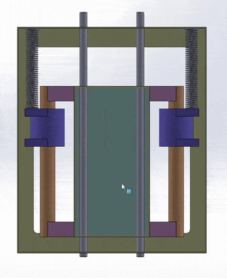

You are right, I have no experience in developing such systems, so I am looking for a designer who can design such a damper. Using a linear motor/generator has the advantage that I can set almost any profile of the braking force depending on the velocity of the body. However, I do not know how to model and calculate this concept. I can send a 3D step file.
If there are any other ideas on how to "hide" the impulse and then smoothly release it, I would be very grateful.
