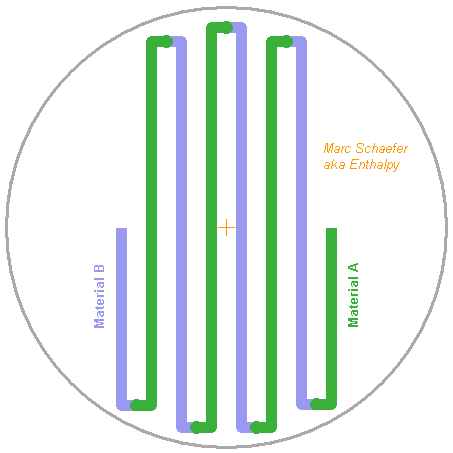

What about a slightly exotic idea? Here I propose to measure the "effective" mass of charge carriers by centrifugal force.
Electrons in vacuum have a mass, and when moving in a solid an other mass, often called "effective" (as if the vacuum mass were ineffective). Centrifugal force creates unequal voltages across dissimilar materials that give a different mass to electrons, and with a proper setup, this voltage seems measurable - which I feel funny.
Referring to the attached sketched (click to magnify if logged in):
Along a radial leg, the centrifugal force creates a voltage of mA * 0.5*(V2-v2) /q in the material A, or mB etc in the material B, with V the outer speed and v the inner one. By making the odd legs of material A and even legs of material B, and putting many leg pairs in series, we get a significant voltage.
At least with metals, the electron work function won't vary with the minute amount of electrons added or subtracted, and nor will the contact potential; other materials need an ohmic contact. And yes, I believe electric power could be harvested, which would be provided mechanically by the shaft, but is technologically uninteresting.
One excellent choice for the disk is a silicon wafer; I take D=2 inches here. An other choice would be a platter of a hard disk drive with its spindle already. Silicon can rotate at 600 m/s (and much more); the inner speed shall be 400 m/s. Take materials that give masses of 1.5*m0 and -1.2*m0 for instance, then each pair of legs offers 1.5 µV; a pitch of 100µm permits 1000 pairs of legs (not all drawn here) resulting in 1.5 mV.
Metal thermocouples can develop 20 µV/K for instance, so the outer and inner temperatures must be much closer than 0.1K: nothing special within metals or silicon, but it must impose to rotate in vacuum.
1.5 mV DC is easy to measure, but not on a disk rotating at 3800 Hz (226,000 rpm). Capacitive coupling with the stator simplifies it and can serve as a welcome chopper. Take a gap of 0.2mm and an electrode width of 0.5mm between r = 10 mm and R = 15 mm: you can put 2*40 of them, resulting in 4.4 pF /2 and 150 kHz, so the signal is 1.5 mV pk at 150 kHz through -j*480 kohm, so easy.
Take a Fet or Mos amplifier, polarize its inputs with 100 Mohm, you get 2.3 kohm noise equivalent from the polarization - or use a pair of diodes for that. The amplifier's noise is similar and the legs can sum to 40 kohm if made of 2 µm thick metal. Noise over a 10 Hz band is 0.1 µV only; with semiconductor legs, shunt the resistance at 150 kHz by a rotating capacitor of few pF on silicon. A 3.5" platter at 7200 rpm would still provide some 15 µV signal.

Enthalpy said:
...By making the odd legs of material A and even legs of material B, and putting many leg pairs in series, we get a significant voltage...
Enthalpy - you are evidently not aware the proposed centrifuge would be acting as a perpetuum mobile if it worked as hoped. Centripetal acceleration forces are acting in effect as a an artificial 'g' field deriving from a conservative potential. The resulting 'voltage' is felt by conduction charges, but it cannot act like a true emf source capable of driving a current through a circuit. [STRIKE]One should expect a compensating 'junction potential difference' wherever the two media join[/STRIKE] [1]. Just ask yourself - where would any back-reaction torque act to slow the centrifuge if such a current did flow? Especially problematic given sign and magnitude of 'g' forces are independent of rotation direction
[1]: On second thought that is no answer. 'Junction PD's' should overall cancel out assuming no variation in magnitude between an inner and outer radius 'junction PD'. Cannot honestly conceive of any plausible mechanism that would provide the needed bias - e.g. centripetal stress-induced variation. That would be sensitive to means of mechanical support of circuit material. So, just how it all balances out is unclear to me at least for now.
Thanks for your interest!
This idea is far from obvious, isn't it? :confused: I believe rotation does produce a voltage, which would even be useable at some current (not interesting for technology, but vital for logic!).
The power for it comes from the shaft, as I imagine it. As heavy electrons flow outwards, their tangential speed increases because they're pushed by the conductor's edge (and resulting field), which consumes torque and power from the shaft. As they come back inwards as lighter electrons they lose tangential speed and do give back some torque and power to the conductor and shaft, but less than on the way outwards, because the electrons are now lighter.:cool:
So this look possible to me. Not a perpetuum mobile but a mechanical-to-electrical power converter, that is, a generator.
On the contact potential... It took some time to convince me :rolleyes:. If the acceleration (or gravitation) potential varies between both contacts to compensate the centrifugal force actingon effective mass, then the idea won't work. But why should the contact potential vary? It's linked with the electron work function. I see only the density of electrons in the metal that would change it, and this variation is so tiny!
So my position is: voltage doesn't balance out and doesn't have to because it wouldn't create a perpetuum mobile. But err... You know, the idea is simple enough (especially with metals and insulating layers deposited on the platter of a hard disk drive) that it can be tested quickly, and thereafter, many people will be able to predict how it necessarily had to behave...:biggrin:

Here another setup which might be easier to build: Build several strips as before, but connect them to a circle with a voltmeter in the center. The voltmeter has to rotate, and needs some way to store or transmit its data, but the whole setup needs less parts.
The remark about dp containing as well V*dm is disturbing!
Let's see...
- The different metals will be superimposed, according to usual semiconductor processes, and current may flow there in any direction chosen by the design. So possible hot electron injection as happens in heterojunctions, which would be parallel here to the rotation axis, should play no role.
- Electron speed due to the current is much smaller than the rotation and should have no importance.
- Imagine the momentum of electron+both metals is conserved (could it be different ?) when the electron crosses the contact: this is exactly what I need! It means no torque is created there.
- I feel this terrain very uncomfortable... I haven't thought through what the momentum-energy relation of electrons in a solid really means. Could it be that, for a given electron kinetic energy in a solid, the difference of momentum to what it would be in vacuum lays in the crystal? What would this imply for the paths outwards and inwards?
Back to the same situation: better try first, and predict afterwards.:-p
But necessary if an actual charge carrier inertial mass change is occurring. Even if the only change is in charge carrier number density there must be a junction impulse. More on that later.
No escape here. Even if flow across the junction itself is axial, current must make a sharp turn to resume tangential flow, and altered mass will show up in ensuing centripetal contribution there. And btw I neglected to fully round this out last time - additional contributions to any overall torques occurs owing to fully in-plane centripetal forces at corners of circuit. Of course in the end this is moot as conservation of angular momentum guarantees no net mechanical torque or power. Still, it's important to know whether carrier effective mass meff and inertial mass mi can be equated, and I'm confident they cannot for reasons already given, and notwithstanding some corrections listed later.
The actual charge carrier speeds - averaged over direction of current - are typically ~ 106m/s and much greater than rotation speed, but owing to a correspondingly tiny fraction of available conduction band charge carriers. See under 'The Sommerfeld Model of Conductivity', pp 4/7, 5/7 here: https://www.physicsforums.com/attachment.php?attachmentid=38139&d=1313832109 Many sites and even textbooks get that one quite wrong. Not that it really matters here. What matters is the product of mean flow speed and carrier density, and of course potentially any fractional difference in inertial mass. I made an error in blue-text edit in #6 in stating only current speed and direction relative to junction mattered re junction impulse. There are additional contributions, but overall they do not matter. More later.
That won't do. Consider case of a single circuit comprised of two semicircular wires of different materials joined at obviously two junctions to form overall a circular loop. Suppose this loop is stationary but carries a steady circulating current. If effective/inertial masses differ, there must be an imbalance of centripetal forces in the two halves. If you reject that a compensating impulse exists in those two junctions...need I add the rest?!
But now for admission. My last blue text edit in #6 was mistaken in that there must be additional contribution to junction impulse owing to circuit rotation. Suppose above circular loop with steady current flowing now rotates about it's own major axis. Just suppose in this case mean charge speed around circuit is uniform and exactly countered by mechanical rotation speed. No centripetal accelerations exist, so no junction impulse will exist either. Had forgotten there must be Bernoulli-type contributions that depend on overall motions. And also any carrier concentration differential in addition to and separate from any actual mi differential. For instance in above loop circuit, non-rotating, suppose carrier densities are different in two halves. Then mean flow speeds will also vary inversely to densities. It's easy to then show centripetal force imbalance exists weighted towards greater force in lower carrier density half. Again, there must be a compensating impulse in the junctions. Bernoulli-type effect I imagine well understood by those versed in solid-state physics. However all of these additional contributions cancel out in respect of a possible emf existing in your rotating circuit arrangement, which can only depend on whether a real differential in mi exists.

Ok, another simplified setup: Make a single loop, orthogonal to the disk. This way, we do not have any movement in phi-direction. In equilibrium (current, electron density & potentials), conservation of angular momentum (in particular: the component orthogonal to the disk) enforces a constant spinning rate. Therefore, with a finite resistance, we cannot have a constant current inside.
The discussed effect would be present in this simple setup, too, but we cannot get a potential here. Therefore, the original setup should not have a potential either.
However, I do not know how to explain that in terms of electron density. We would need different situations at inner vs. outer connection, which depends on the potentials? Looks strange. But we have quantum mechanics, so a potential-dependence is indeed possible.
Meaning I take it with loop on centrifuge periphery, and loop major axis tangent to periphery of disc it's mounted on. That does side-step conservation of momentum issue it's true, but still implies 'free energy' since it's now 'even more impossible' for any energy balance - assuming we are talking having an emf in loop circuit.
Potential difference, or emf? If only the former, any initial centripetally generated PD likely rapidly neutralized via charge redistribution. Which is how I believe it works for a bar electret. Unlike for a bar magnet where free magnetic charges do not exist. For an emf none of that matters.
Are we still talking effective/inertial mass differences in circuit, or something else?

This one has D=600mm and can use a bicycle wheel. It rotates at 0.4Hz so gravity exceeds centrifugal force, and this latter cancels out anyway along the conductor path.
The conductors are macroscopic wires of metals whose electron "effective" mass differ by 3 vacuum masses. 2*200 wires shall then produce 18nV at 0.4Hz. Yes, it needs shielding. It also needs a uniform temperature that doesn't cycle at 0.4Hz.
The amplifier rotates with the wheel. Build an instrumentation amplifier with an LTC6241 for instance: at 70nV/sqrt(Hz) around 0.4Hz for each opamp, an FFT must accumulate data for some 5 min to get 5 sigma signal-to-noise ratio.
Trouble... Very probably, this one doesn't work for being a perpetuum mobile. The only possibility would be that the shaft brings power, just like when you rotate a tube with a ball in it, and for a short time, the ball's movement means true work. This is the only reason why I take a CMOS opamp here: it's more noisy but if the total charge of the signal is limited then a CMOS is more likely to pick it.
What if the centrifuge produces a signal and gravity doesn't? Uncomfortable... It could be that electrons in a metal respond differently to acceleration and to gravity - something new.
And what if neither the centrifuge nor gravity produce a signal? Then maybe the contact electric potential changes with the gravity potential.
Marc Schaefer, aka Enthalpy
Credit is due for innovation here. Not exactly clear on the need for rotation. As for the centrifuge design, IF indeed meff = mi, the series coupled pile will output an emf and one needn't worry about charge neutralization over time. For sure noise will be at such feeble levels indicated, but you have that covered it seems.
That pm issue is still present in principle - as mentioned above, meff = mi and one has an emf, rotation or not. So it really gets down to that one thing here - is meff = mi? I notice from another thread there has been an input that seems to be to the effect that meff is essentially a charge-carrier de Broglie wave/lattice interference type phenomenon. This is where one must be real sure of the nature of this meff beast imo. Still, as before, if this mark II device is now within fairly easy reach - likely only experiment will give you peace of mind, so...:rolleyes:
