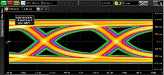

As an electronics engineer, I would add that at very high frame rates the timestamp itself becomes a nontrivial measurement. Clock jitter is already a major limitation in high-speed instruments, so a "femtosecond movie" is not simply a matter of making the camera faster. The timing chain introduces its own uncertainty.
I think the point of @renormalize post was that finite-resolution measurements can provide a time-resolved record of particle motion without requiring exact localization at every instant. I'm sure if you were careful you could build an ultrafast experiment here, you just aren't going to do it with a quartz crystal.
Probabily your knowledge on PLL phase noise is better than mine. I only have a patent on synchronization telecom equipments (100Gbps), so little knowledge of keeping track of timing on labs for physics experiments CERN, LIGO. etc where 10-12 precision is probably not enough.

The eye diagram makes my point rather than yours. It's a good tool for the problem it was built for. It's the wrong tool for the one under discussion, which is what "not with a quartz crystal" meant.
Ultrafast imaging doesn't derive frame times from an electronic clock at all. STAMP encodes them in pulse sequence and dispersion: https://www.nature.com/articles/s41377-018-0044-7. This group, https://opg.optica.org/josab/abstract.cfm?uri=josab-35-11-2822, set them with mirror-array path-length differences, where 1 µm of path is 3.34 fs. T-CUP and CUSP use temporal shearing and spectral–temporal mapping: https://www.nature.com/articles/s41467-020-15745-4. What you won't find anywhere are PLLs.
