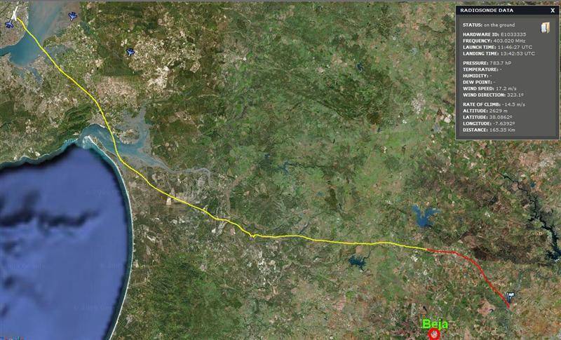

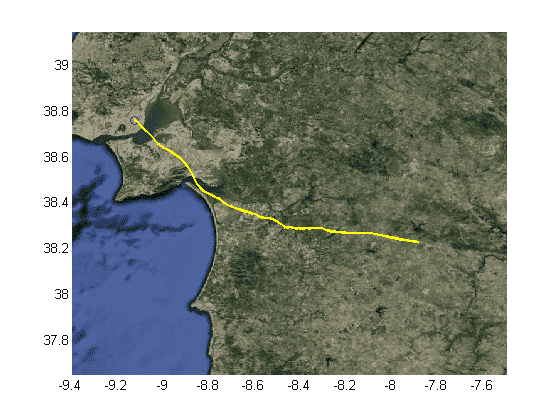

hi Voko,
I finally had time to finish the program. I used simple equations of motion (#12). The result in my opinion is very good. Figure 2 show the result (using the equations), figure 1 show the true path measured by sensors on the surface (while radiosonde is in the air). This is just one example, I used more cases to validate the results.
Thanks for all the help.
