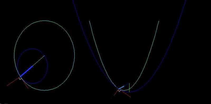

You can't if all you know is the velocity and acceleration. Think of it this way: The gravitational acceleration toward an object of mass M and distance r is -GM/r2, directed toward the mass. Double the distance and quadruple the mass and you get exactly the same acceleration, but a very different orbit.

No, it cannot.
Suppose you find that, given the instantaneous velocity and acceleration at some time epoch, one possible explanation of the explanation is a mass [itex]m[/itex] located some distance [itex]d[/itex] away, in the direction of the acceleration vector.
The problem is this solution is not unique. A mass [itex]4m[/itex] located some distance [itex]2d[/itex] yields exactly the same acceleration, as does any mass, distance pair of the form [itex]\kappa^2m, \kappa d[/itex].

The problem is indeterminate. All you know is the direction in which the massive object lies. The distance to that object is [itex]r=\sqrt{GM/|\boldsymbol a|}[/itex]. You don't know the mass; it is a free parameter. Vary the mass and you can make the distance be any value from zero to infinity. That you also know the velocity doesn't help a bit.

as we know Force([tex]\theta[/tex]) = 0 , Force(Radius) = K (something u said in ur question "2- acceleration")
[tex]\theta[/tex] = 180 - A (forgot to show on picture)
all of the sentences with e[tex]\theta[/tex] equals to Zero
so we will have :
R'' er -Rw2 = K
and if i haven't made any mistake in my paper i have calculated R'' :
R'' = (V Sin(X) (eCos[tex]\theta[/tex]+ e^2))/R
then multiple both side of R'' - Rw^2 = K by R
luckily it didnt become a quartic function :D (how ever if it would there was one shifty sentence in function -R-.)
and for the eccentricity (spell?) (e) it is possible to calculate but i haven't study ellipses yet so i don't know atm but i will think about it
(in the first page somebody said something about this but i don't know what that is)
