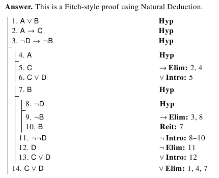

Here's this week's problem.
From $A\lor B, \; A \to C, \; \neg D \to \neg B$, prove
$C\lor D$. You may use any valid first-order deduction system, but you
must indicate which one you are using (Copi's 19 Rules, Natural
Deduction, etc.).

Here is my answer:
