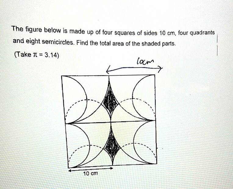

See attach
none

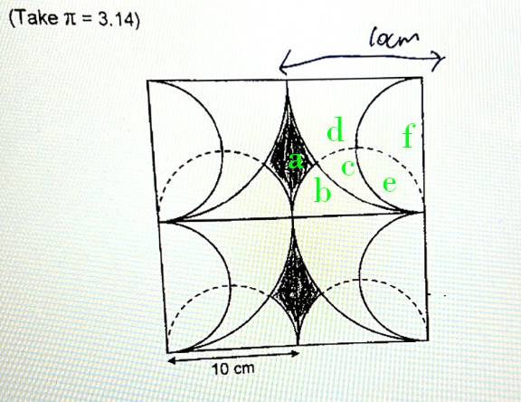

I can find the area of e and f but otherwise am stuck with many simultaneous equations. i don't think my approach is correct though considering it is an elementary school problem. it should be simpler?
1 semicircle area = π(52)/2 = 12.5π = 39.25 cm2
Square area = 10x10 = 100cm2
Square – 2 semicircle = 2 edge = 21.5, so 1 edge = 10.75
so 2 e + edge = semicircle
e = (39.25 – 10.75) / 2 = 14.25 cm2
so f = 39.25 – 14.25 = 25 cm2
area of quad = 1/4 * pi * 102 = 25pi = 78.5 cm2
c+d = quad – (e+f) = 39.25 cm2
b+c = semi – e = 25cm2
also, 39.25 – c = b+e = b + 14.25
so c = 25 - b
get rid of c by setting them equal so, 39.25 – d = 25 - b
so d = 14.25 + b
a + b + quad = square
a + b =21.5 cm2
a+d + b+c+e+f = square
a+d +64.25 = 100, a+d = 35.75
sub d in, a+14.25+b = 35.75, so a+b =

It looks tricky. One approach is to note that, with ##R = 10cm##:
$$a = R^2 - (b + c + e) - (d+f+e + c) + (e + c)$$$$= R^2 - \frac{\pi R^2}{8} - \frac{\pi R^2}{4} + (e + c)$$The problem is then to calculate the area ##(e + c)##. I've seen this before:
This gives a different expression from the one @docnet gave, but it's the same numerical answer.

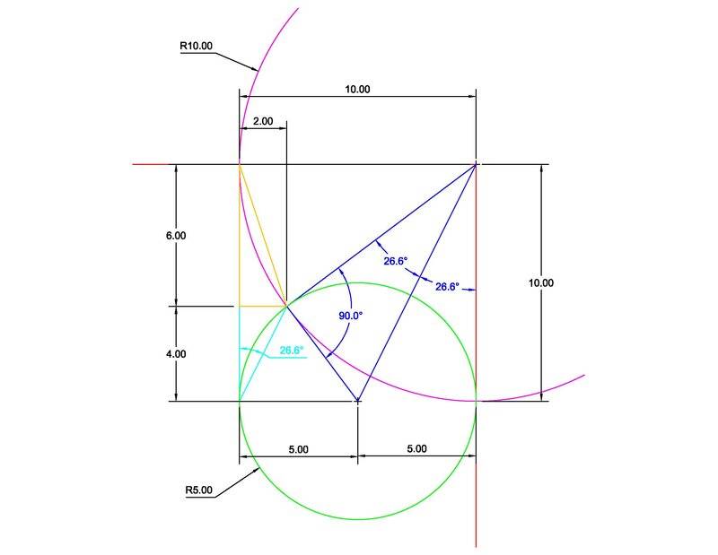

You don't even need to calculate those areas, which are only distractions produced by the irrelevant vertical semicircle.
By using only trigonometry, I would calculate the areas of the two triangles formed (orange and cyan colored) and containing the area of interest.
Note the 1:2 proportion of the radii.
Then, would subtract the areas of the two circular segments.
Please, see:
https://en.wikipedia.org/wiki/Circular_segment

BTW from the Figure I see
[tex]\theta_1=2 \tan^{-1}\frac{1}{2}[/tex]
According to your result
[tex]\theta_1=\tan^{-1}\frac{4}{3}[/tex]
They equal to 0.9272... Is the equality of these inverse trigonometry functions obvious?

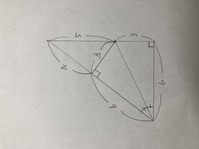

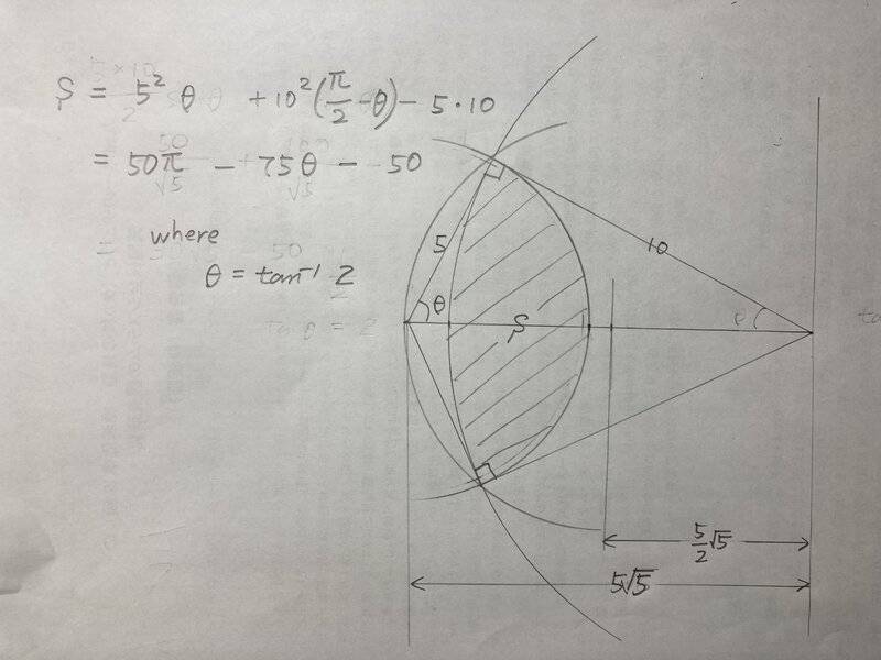

Now we see it obvious.
