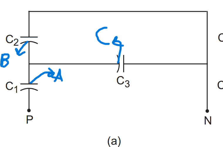

refer to the image below. assume that there is a battery connected at P, such that the positive terminal is connected to the wire through P. explain:
a) Is the potential at A, B and C and the branch of this wire at the same potential? Why, or why not?
b) is there an electric field in the wire at this region?
## \mathbf{E} = - \nabla V##
I am very confused, all i have thought about right now is that, in that isolated branch connecting A, B and C, the net charge would be conserved. Not sure how to proceed. I feel that
, if there is a charge ## -Q ##at A, and a charge ##-Q_1 ## at B, then the charge at C MUST be ## Q+Q_1 ## maybe somehow, due to these charges, there would be an electric field in the wire. But my mind tells me that there should be no current hence no electric field, due to electrostatic equilibrium. (thereby constant potential?!?) Not sure which is right, and would appreciate any help.
Assuming that all capacitors are uncharged before connecting them to the battery, once they are connected, there will be a transient current until the capacitors are fully charged. When equilibrium is reached, current will stop flowing and the wires connecting the capacitors will be equipotentials.
The isolated "T" shaped piece that you mentioned will be at a higher potential than the wire connecting N to C3 and C2 but lower potential than the wire connecting P to C1. This is accomplished by the battery pulling a certain amount of electrons from the the wire connecting P to C1 and adding the same amount of electrons to the wire connecting N to C3 and C2. As a result the electrons in the "T"-shaped piece are redistributed internally. The entire assembly from N to P is electrically neutral.
Alright, I understood the equilibrium part, so the electric field in that region is gonna be zero.. is that right?
alright so that means that the parts connected to N i.e the parts of the capacitor that I have NOT marked, are going to be positively charged. that means that the parts I HAVE marked, i.e B and C are both going to have a positive charge. Hope this is correct.
Also, I do not know much about current electricity, but I am curious to know- is it always the case that in electrostatic equilibrium, or in any other case, the net charge is zero? (I mean sum of the charges when I say net charge)

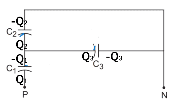

Charge conservation of ABC "T" part
[tex]-Q_1+Q_2+Q_3=0[/tex]
Voltage of ABC "T" part measured from N
[tex]\frac{Q_2}{C_2}=\frac{Q_3}{C_3}[/tex]
PN voltage
[tex]\frac{Q_1}{C_1}+\frac{Q_2}{C_2}=V[/tex]
Three equations for three parameters. Isn't it enough ?
PN voltage
