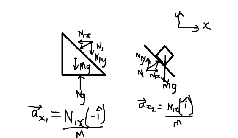

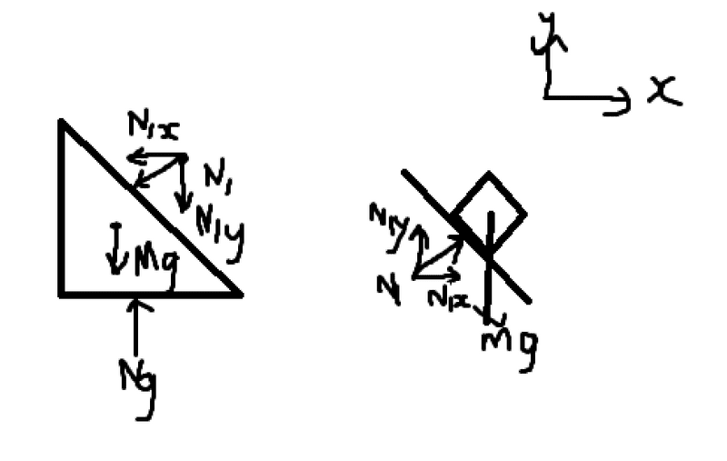

okay, now, I drew a free body diagram of the masses to predict how they would behave:-
here N_g represents the normal reaction from the ground, and N_1 is the internal normal reaction between the two blocks. I have divided that into two components. So from here, it is clear that the larger mass M is going to move towards the left, with some acceleration.

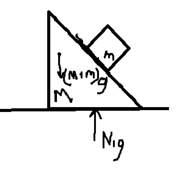

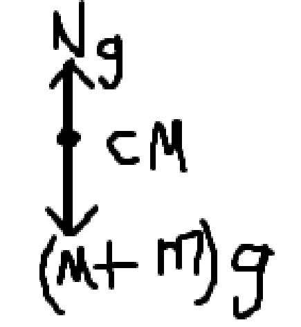

DOUBT 2: FBD of the "system"

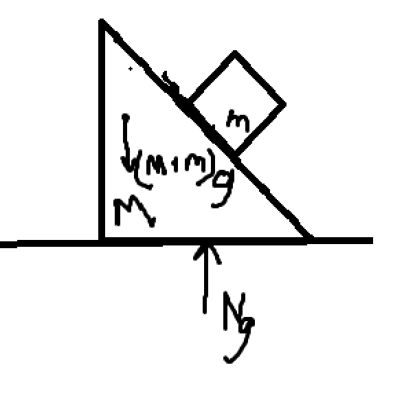

so in addition to these, I am going to draw the FBD of the system as defined earlier:
the forces acting on the system are (M+m)g and the normal force from the ground, N_g.
POINT 1: as there are no external forces operating in the x- direction,

Now going back to the FBD of the the individual blocks,
where $$ a_x1$$ is the acceleration of the larger mass and $$ a_x2 $$ is the acceleration of the smaller mass.
So clearly, $$ a_{cm,x} = 0,$$ using an equation similar to (1) above.
now, it seems to me that $$a_{y1}$$ is zero, as I do not see the larger mass M accelerating along the y direction. However, it is clear that the smaller mass has some acceleration in the y direction.
from this, substituting values in equation (1), the y- component of the acceleration turns out to be non zero. However this contradicts the statement made above.
Where have I gone wrong in this analysis? is the CM stationary along the y plane?
|View attachment 357556
so in addition to these, I am going to draw the FBD of the system as defined earlier:View attachment 357558

Intuitively the normal from ground must balance the weight of the system right?
This would be correct only if the center of mass of the system is not accelerating in the vertical direction.

So the FBD on the left is more apt for the system of m+M? External forces on system are basically external forces on the CM right? so the diagram on the left implies that the CM is not at rest and has some acceleration in the y direction? If I use second law for the CM and find the acceleration, the result does not look the same as obtained from this equation:

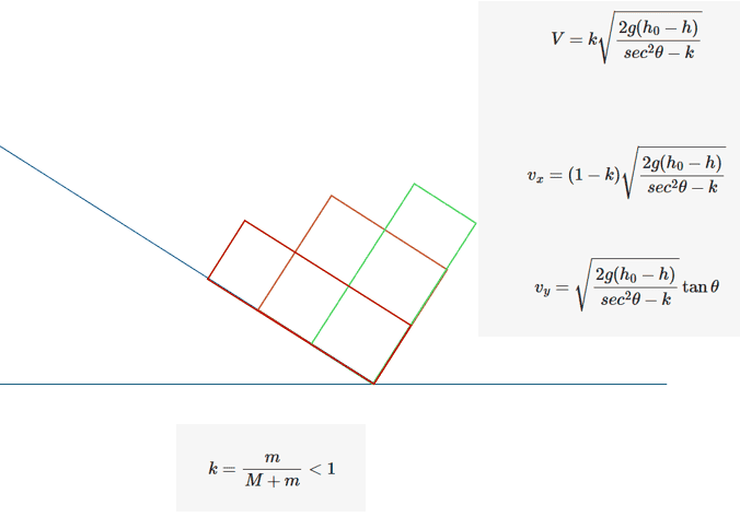

While they are in contact:
X-momentum conservation
[tex]MV=mv_x[/tex]
Energy conservation
[tex]\frac{1}{2}MV^2+\frac{1}{2}m(v_x^2+v_y^2)+mgh=mgh_0[/tex]
Where
[tex]\frac{v_y}{v_x+V}=\tan \theta[/tex]
With convention that all
[tex]V,v_x,v_y,h> 0[/tex]
are in natural direction. Solving for V
[tex]V=k\sqrt{\frac{2g(h_0-h)}{sec^2\theta-k}}[/tex]
Thus
[tex]v_x=(1-k)\sqrt{\frac{2g(h_0-h)}{sec^2\theta-k}}[/tex]
[tex]v_y=\sqrt{\frac{2g(h_0-h)}{sec^2\theta-k}}\tan\theta[/tex]
where
[tex]k=\frac{m}{M+m}<1[/tex]

I draw sketch to take a look at whether the block will contact with the edge again after its ground touch.
The sketch shows the moment of floor contact. The velocities are calculated in [EDIT] of my post #20. Say the floor would provide perfect elastic y-force but no x-force. The shape and density homogeneity/inhomogeneity of the block is open. My conjecture is no contact again because V and vx are in opposite direction but I am not sure of it for various cases.
By re-contact |x-momentum| of each body increase or decrease the sum of which is zero ? Increase requires conversion of y-energy. Falling part of the block should contact the edge slope.
Decrease seems impossible. How edge slope which is frictionless and perfect elastic can decrease |x-momentum| of the block?
