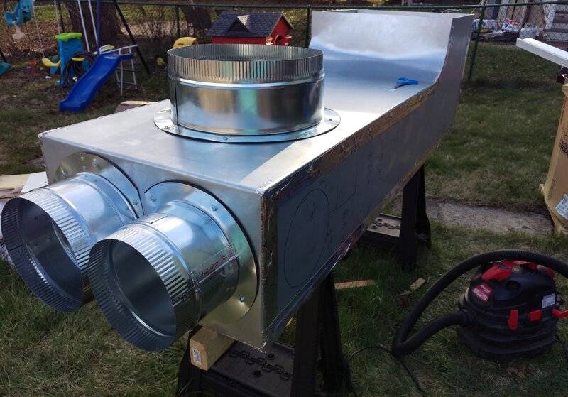

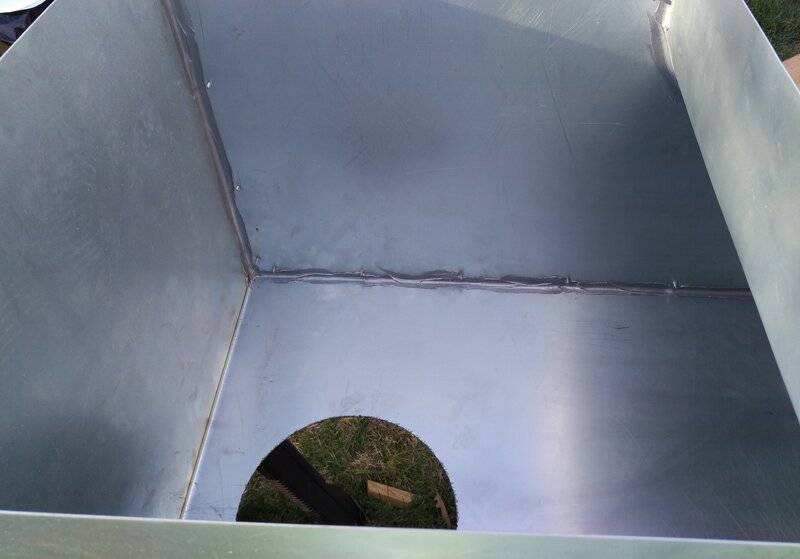

After looking at things a bit there are some possible weak points I forgot about.
I feel most of it is sealed in ways that shouldn't fail for a long time. But there's two "canvas connectors" I made up, one for each side of the air handler which decouple it from the duct work. Since they're seamed it's possible that split open. I'll need to inspect. Also where the return side connects to the air filter I don't think I was able to get in there and tape the bottom joint. It was tight and metal the metal but certainly not perfect.
This is the 20 gauge return plenum before it was installed. Besides the connections you see there's also a 9" on the back towards the open end that goes to the air handler.
Just so there's no confusion this is the suction side of the system. The supply side is much more spread out via two 14" round ducts that go the length of the house

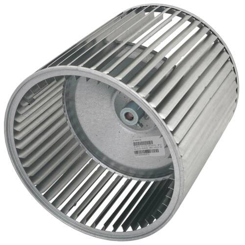

Ok so, as much as I didn't expect this there actually was some dust buildup on the vanes. I assume from the high humidity (blower being after the evaporator) and apparently dust gets through even a merv 8 filter with foam gaskets all around it. Can't be much, because the evaporator was very clean.
Curious, why would a small amount of crud on the vanes cause the howling? Slight imbalance?

Here's a picture showing some of the accumulation. It's not filthy, just a lot worse than I expected. Maybe it's not even enough to matter?

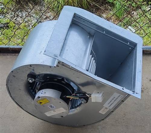

No, the motor fits into one side of the squirrel cage and is located in the unit. I didn't see any places I thought air could get in other than the less than perfect filter housing.

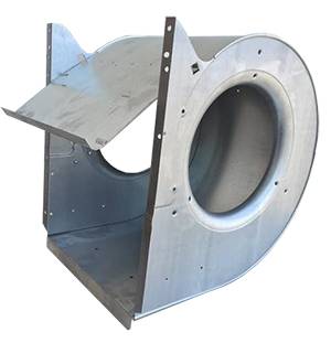

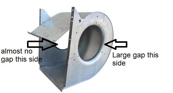

Between the weather, and me coming down with what I think was the flu (it wasn't fun, regardless) I finally got things cleaned up and back together but barely got to test anything.
The only thing peculiar that caught my attention was the blower wheel wasn't centered in the housing, remember it pulls from both sides. I don't know if it would ever matter, but it had almost no gap on one side, and a good 5/16"+ of a gap on the other. I'm sure it wasn't rubbing, but I don't know if the large gap on one side could do something funky as far as oscillating etc.

Could you please post a diagram clarifying your explanation?
I don't have a diagram handy, but here's a few pictures that show the design of the blower assembly. These are not of the actual one I'm dealing with, but it's the same style. The motor is mounted inside of one end of the wheel but with a decent gap around it so it can pull air through. The blower pulls air in both sides of the wheel. In my case, there was a fairly large gap between the wheel and housing on one side, and almost none on the other (motor side). I can't imagine the tolerances are very critical on something like this, it's just something that stood out.
