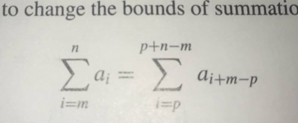

Good afternoon 😃 Can someone explain to me how to change the bounds of summation using this example please?
As per picture
What does ##\sum_{i=k}^m a_i## stand for?
Try ##j = i - m + p##.

i stands for the positive integer , ai stands for a unique number and m and n are positive integers with m being greater or equal to n.

No, that's what the "numbers" mean. But what is the abbreviation ##\sum## for?
Write both sides out with the definition of the summation symbol. Shouldn't be too hard to see thay are the same.

(Notice that fresh has changed some of the variables from those in the problem statement.)
Think of what @fresh_42 was getting at more like:
##\displaystyle \sum_{i=m}^n a_i## stands for:
##a_{m} + a_{m+1} + a_{m+2} + ... + a_{n-1} + a_{n} ##​
In words, sum the ##a_i ## values, where ##i## takes on values from ##m## through ##n##.
With this in mind, do a similar translation for the right hand side. It may help to use an index other than ##i##, initially.
##\displaystyle \sum_{j=p}^{p+n-m} a_{j+m-p}##
Plug ##p## in for ##j## to get the index for the first term in the sum, then plug ##p+n-m## in for ##j## to get the index for the final term.
(Added in Edit: Fixed summation per @archaic's comment in the next post.)

You forgot to change ##i## to ##j## in the second symbol :)
