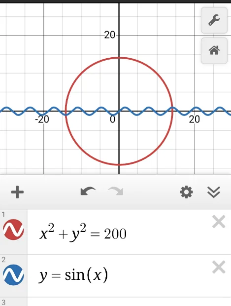

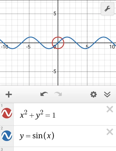

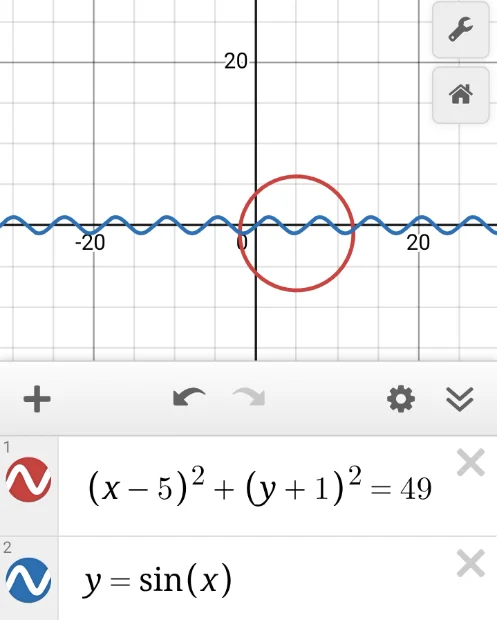

I tried your recommendation on the desmos.com graphing calculator and I was always getting 2 points of intersection for various circles that I tried.
Below are three scenarios that I tried, and they all always intersect at two points. But logically, I cannot arrive at this conclusion of two points. Also, I can understand that if the circle has its center very distant above or below the x or y axis and having a small enough radius then such a circle would have no intersection points with the sine curve.

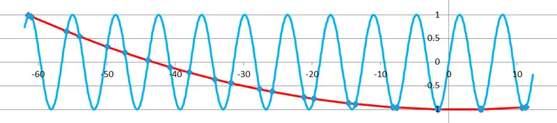

It seems that none of the options given in the challenge problem under post#13 is true.
I counted the number of intersections in post#10 to be greater than 16.
I also counted the number of intersections as 2 in post#3 .
In that case, shouldn't this challenge problem be wrong?

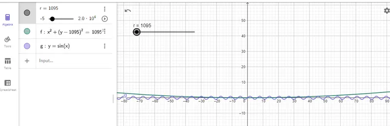

First off, sorry for becoming unavailable. My follow-on hint would have been to try b=r-1, r>10.
