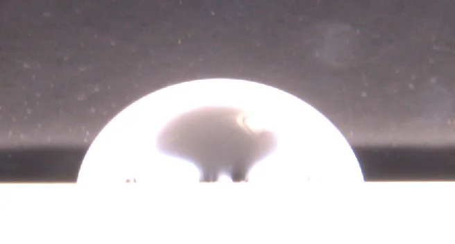

I am studying the contact angle of a sessile droplet (water and alcohol mixtures) on both horizontal and inclined surfaces. I capture side-view images with a 24 MP Canon camera and analyze them with a CNN-based pipeline in Python. However, I have run into several issues:
  1. A 24 MP Canon seems to have enough resolution, but I still find it hard to determine the contour from side-view photos of the droplet, and therefore the contact angle, even after using CNN and other analysis tools in my Python code.

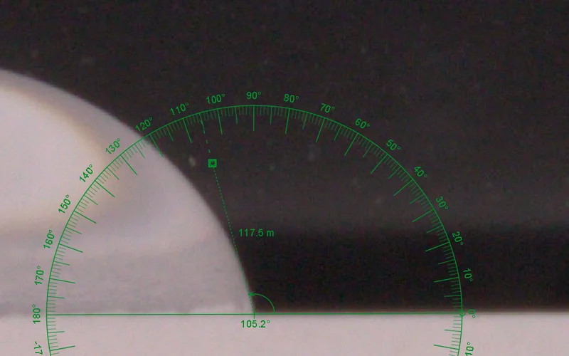

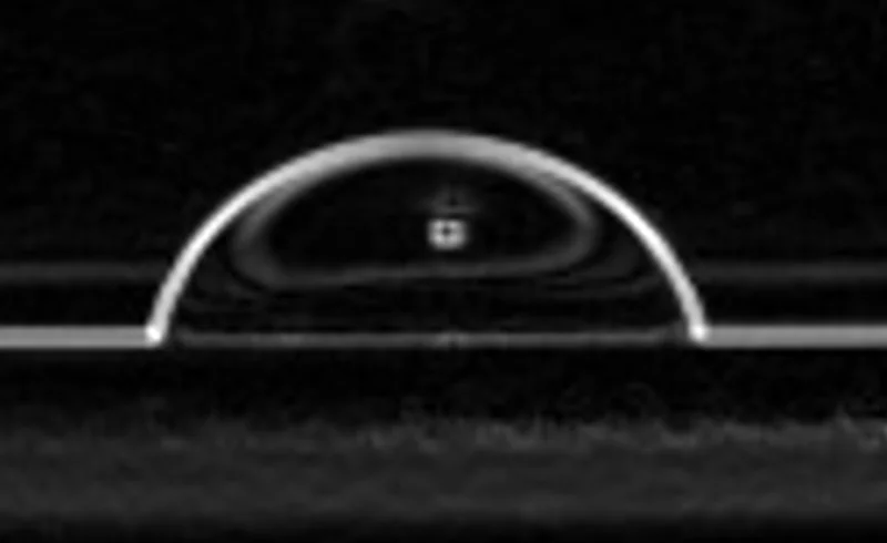

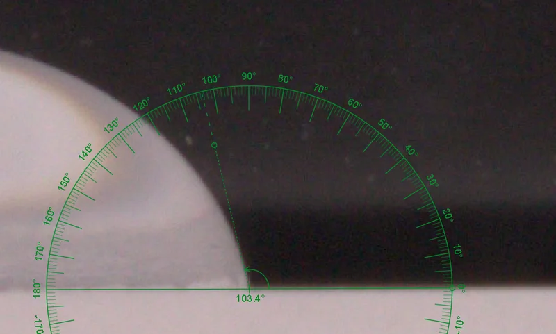

The first picture above shows the side view of the droplet, and I focus on analyzing the right contact angle, as illustrated in the second and third figures. However, I’m unsure which measurement approach is correct - specifically, how close the diagonal lines should be to the contour of the water droplet. Both methods seem reasonable. A similar issue came up when I tried to automate the analysis with code. I also used the image processed by CNN (Sobel operator), but it didn’t really improve the situation:

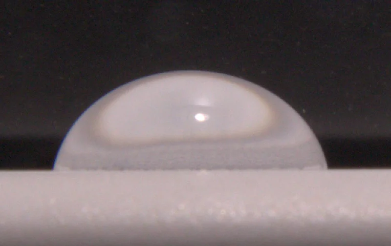

  1. Lighting problems: As shown above, different regions of the droplet show different colors. Under strong light, the center of the water droplet even appears noticeably darker than its surroundings. Also, I wonder whether a black background (including the table and the screen behind the droplet) is preferred.

This type of measurement was a major part of my dissertation. As you have noticed, it's not a simple measurement. I have a few thoughts/suggestions:
Most important: what is your measurement goal in terms of accuracy and precision? Do you want 2 significant digits or 4? "As accurate as possible" is a bad goal.
Lighting: backlight the drop so it appears in silhouette. If you can illuminate with a monochromatic plane wave, that's even better.
Evaporation: as the alcohol evaporates, the contact angle will change.
Sample prep: if the surface is even slightly rough (or there is heterogeneous adsorbed material), you will get contact angle hysteresis, which will become apparent as you apply the drop to the surface. Make sure every drop is dispensed (almost) exactly the same way.
Surface prep/repeatability: microsurface properties impact the macroscopic contact angle. Re-using the same surface over and over will not give repeatable results due to chemical contamination (residue from the fluid, impurities in the fluid, air humidity = adsorbed water, changes to surface roughness if there is a pre-existing fluid film, etc. etc.
Magnification: I don't think it's 'standardized', but you really need to be imaging at the microscale- 0.01 to 0.1 mm length scales.
Good luck!

There's a technique for determining the contact angle that relies on measuring the droplet aspect ratio. I don't know how useful it is in your case. The geometry of a droplet on a hydrophilic surface is such that the angle between half the base width and the height is equal to half the contact angle. This is called the theta/2 method.
See fig 1 in this publication
https://www.researchgate.net/public..._used_in_medium_and_high_voltage_applications
I once used a similar method in which I calculated the ratio of drop height to width based on a photo when I was doing home experiments on obtaining superhydrophobic surfaces.
