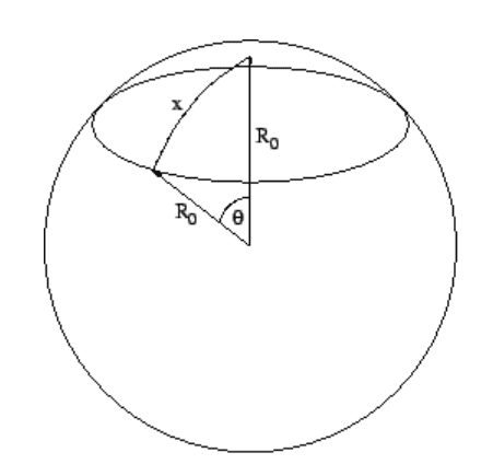

Here's how I've always understood it:
Taking a 2D surface of a 2-sphere as an analogue of a positively-curved 3D universe, the radius of the observable universe is the radius of the circle drawn on the surface of this sphere (x). The radius of curvature of the 2D universe is the radius of the 2-sphere (R0):
In 3D hyperspherical universe, the radius of the spherical 3D volume that constitutes our observable universe is the analogue of x. The radius of curvature is the radius of the 3-sphere on which the 3D volume is drawn, analogous to R0 above.
Okay I see your point.

Arman777 said:
So ıf the universe is curved we are actually measuring the radius of the universe ?
As long as you understand that it's the radius of the curvature of the universe, i.e. the radius of the higher-dimensional hypersphere, not anything within the 3D space.
For 2D sphere as a 2d creatures radius of the universe is not a meaningful thing. Radius of curvature has some meaning ..? I guess that is your point ?
Yes.
For the 2D flatlanders living on the surface of a sphere:
- radius of the observable universe has a meaning, and it's how far on the surface of the sphere they can see;
- radius of the universe has no meaning, since it'd be the distance to the boundary of the surface, and the surface of a sphere has no boundary;
- radius of the curvature of the universe has a meaning, since it tells one how curved the geometry of the 2D space is, but it is not a distance between any two points within that space. A flatlander can't point anywhere on the 2D surface and say 'the centre of curvature is R0 light years that way'.
