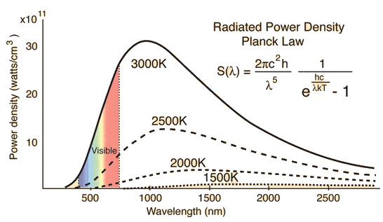

It is said that CMDB originated when the universe was 3,79,000 years old and almost 41 million light years and the temperature was around 3000 K. Every point in space became of source of radiation in all directions. The radiation spectrum was that of a blackbody at 3000 K. The blackbody spectrum at 3000 K is shown below.

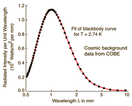

Because the universe has expanded and is still expanding, the original spectrum has red-shifted and now corresponds to that of a blackbody at 2.74 K as shown below.
Please note that the first spectrum at 3000 K has 'wavelength' scale in nm and the one at 2.74 K has it in mm.
Yes. The ratio of temperatures is the same as the ratio of scale factors, and in turn is derived from the observed redshift of the CMB; the redshift is the actual observed quantity that is the basis for all the other numbers. The scale factor ratio is ##1 + z## for redshift ##z##.
