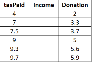

I am trying to make some fake data that reflects the particular situation you describe, i.e.
but in most states, donations to charity reduce the amount of tax you pay, and so we might expect to see the correlation between donations and tax to become negative.
How would the income column need to look like to match that scenario? taxPaid and Donations are positive correlated. What values could I use for Income? I am not sure....
A simple model would be tax paid = 25% x (Income - Donations), just generate some pseudo-random figures for income and donations in a sensible range and calculate the tax paid (adding noise if you want).
