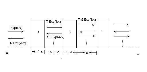

Sorry,Maybe I failed to express my thought properly.
What I mean is that:
I summed the scattered waves and can't get the result that "wave can propagate without attenuation".I don't know what's wrong,so I wonder if I can find some reference or some calculation based on this idea.

Take periodic square barrier potential for example.As illustrated in the figure,a plane wave Exp(ikx) incident on barrier 1,and if there is no other barrier the transmitted wave and reflected wave is T*Exp(ikx) and R*Exp(-ikx).When there are other barriers the scattered waves will be scattered and then scattered once and once.I add up all of these waves and can't get the result that the Exp(-ikx) terms canceled.I want to know what's wrong?
Just how exactly did you add all of them? I mean, your "x" is only valid for a particular square barrier. Other square barrier are at locations x+R, x+2R, x+3R... and x-R, x-2R, x-3R, ... where R is the lattice constant. You then have the Bloch boundary condition where [tex]\Psi (x+nR) = \Psi (x)[/tex]. So considering all of these necessary criteria, I do not know how you "add" these things.
Zz.
Zz.
I'll reconsider it.Thank you very much!
Also notice that you are not using periodic (BvK) boundary conditions in the way you set up the problem - in fact, it's not clear how you pick an origin. So, you will not get Bloch solutions going about it this way.
