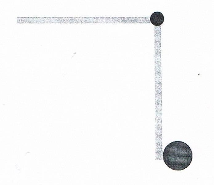

"A bar line AB has a length of 1,5m and a mass of 0,5kg.
It is stuck in the point B in a horizontal fixed hub, and it can oscillate freely with no friction in the verical plane.
at time t=0, the bar line, which was still (not moving, inertia), is set free to rotate.
When it reaches the vertical position it hits a body of mass m2 = 0,2kg.
The bar line immediately stops, while the body m2 begins to move after the collision with a horizontal velocity.
Find: The angular velocity of the bar line, the linear velocity of its free extreme point (so A, i guess), and the velocity of m2 after the collision.
We have then:
AB = 1,5m
m1 = 0,5kg
m2 = 0,2kg
v0 = 0m/s
Alright, I didn't do too much actually, I am just starting out with these kind of problems.
I understand that as soon as the bar line is set free, it starts a circular motion, and the final velocity depends on the gravity acceleration ( I guess ). And that the impact will be at angle teta = pi/2.
Now, I don't really know where to start from.
I am thinking about finding the center of mass, is that the right path to begin with?

Find the center of mass of the bar and determine how much its (gravitational) potential energy changes between the horizontal and vertical positions. This will tell you how much rotational KE it will gain. Use your knowledge of rotational mechanics to determine its angular velocity, etc.

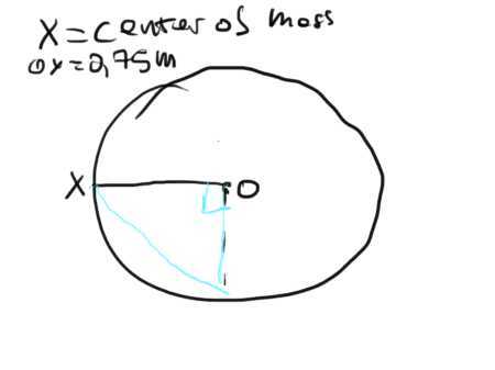

Since there is no talking about density I can assume the center of mass is just L/2 so:
x = 0,75.
Right? Now I understand that I have to do something with energy, so like:
mgh = 1/2mv^2
But I have to decompose the motion in x and y. I am not sure if this is correct but this is my basic idea.
But I don't understand how may I find the angles in order to get the x and y components of the height.
x = 0,75.
mgh = 1/2mv^2
That's good.
No, no decomposition is required. The change in gravitational PE for the center of mass of the rod goes into the rotational KE of the rod. There's only one rotational velocity, so no components required (a nice feature of rotational motion!) What's the formula for rotational KE?
